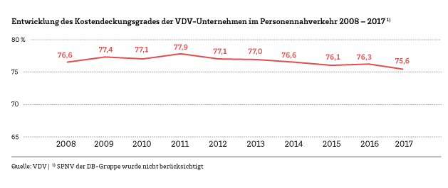

I doubt that there are many (if any) cities on this planet with very decent public transit which recover all of their operating costs.
If we look at Germany, the farebox recovery rate for public transit systems in Germany hovers around 75% (most probably much less during Covid times):
Source: German Association of Transport Companies (VDV)
Furthermore, the farebox recovery rate seems to be lower in metropolitan areas as these examples show:
