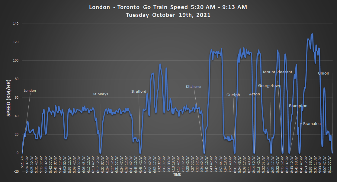

So according to Trainssee and some people in the area, the speed restriction at Shakespeare between Stratford and Kitchener has been lifted and trains can now go 60 mph there. This saves 4-5 minutes. This could possibly put the total travel time at 3hr 43 mins. Still a long way off from the possible 2hr 40 minutes with the 1970s historical speed + Kitchener - Toronto improvements.
Great news! Based on the chart you posted earlier, this was the lowest-hanging fruit along the line: a short 30 mph slow order in an otherwise 60 mph zone. Hopefully they are also working on the two other similar slow orders (one just east of Stratford and the other crossing Hwy 7 west of New Hamburg).
Speed diagram previously posted by Krypto98
london-toronto-png.356687
Location of the 30 mph slow order which still exists west of New Hamburg (as of today):
I highly doubt the time savings of resolving the single 30 mph slow order in Shakespeare would be 4-5 minutes, given that it was only a couple hundred metres long, and even a full station stop on a 60 mph line only adds about 2 minutes, including coming to a full stop and sitting still for 30 seconds.
And by the way, how do you make these charts? I looked quickly on transsee.ca but I didn't see any obvious way of exporting data.
I copy and pasted each individual line into excel and formated with one column with time and another with speed. I'll likely make another chart soon with the Guelph speed improvements.

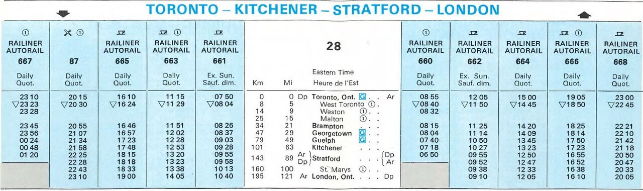

What was the 1970s time for kitchener to Stratford?
Another correction, They are usually now 3 minutes early at stratford. Thus including duel time, i only see this improving the schedule by 2 minutes.
Best time in the Jan 7 1970 timetable - westbound #159 - 27 minutes (plus 3 mins dwell in Stratford), That was a conventional train.
From June 1 80 - with most services running as RDC trains - westbound # 665 - 27 minutes plus 3 dwell in Stratford
May 5/91 - with service reduced after the Mulroney cuts - #80 eastward, 29 minutes (no dwell shown)
2001 (GEXR) - #87 - 29 minutes
2009 (GEXR) - #84 - 27 minutes
2017 (GEXR) #85 - 37 minutes
I meant where did you get the data to copy to Excel?
Here's April 1976 (27 min travel + 3 min dwell, same as the tables described by crs1026):

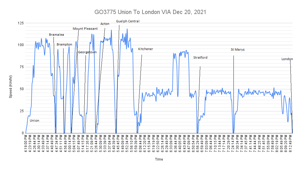

So how do you make the schedule reflect the original schedule before the track deteriorated? Shouldn't they be able to shave an hour off that trip?
I don't know exactly how to do that but if GO3775 followed the 1970s schedule, the schedule would look like this
4:19 Union
4:46 Bramalea
4:53 Brampton
5:00 Mount Pleasant
5:12 Georgetown
5:26 Acton
5:41 Guelph Central
6:06 Kitchener
6:33 Stratford
6:48 St Marys
7:15 London
You Could subtract an additional 5-7 minutes for the Guelph Speed increases since that is not reflected here.
