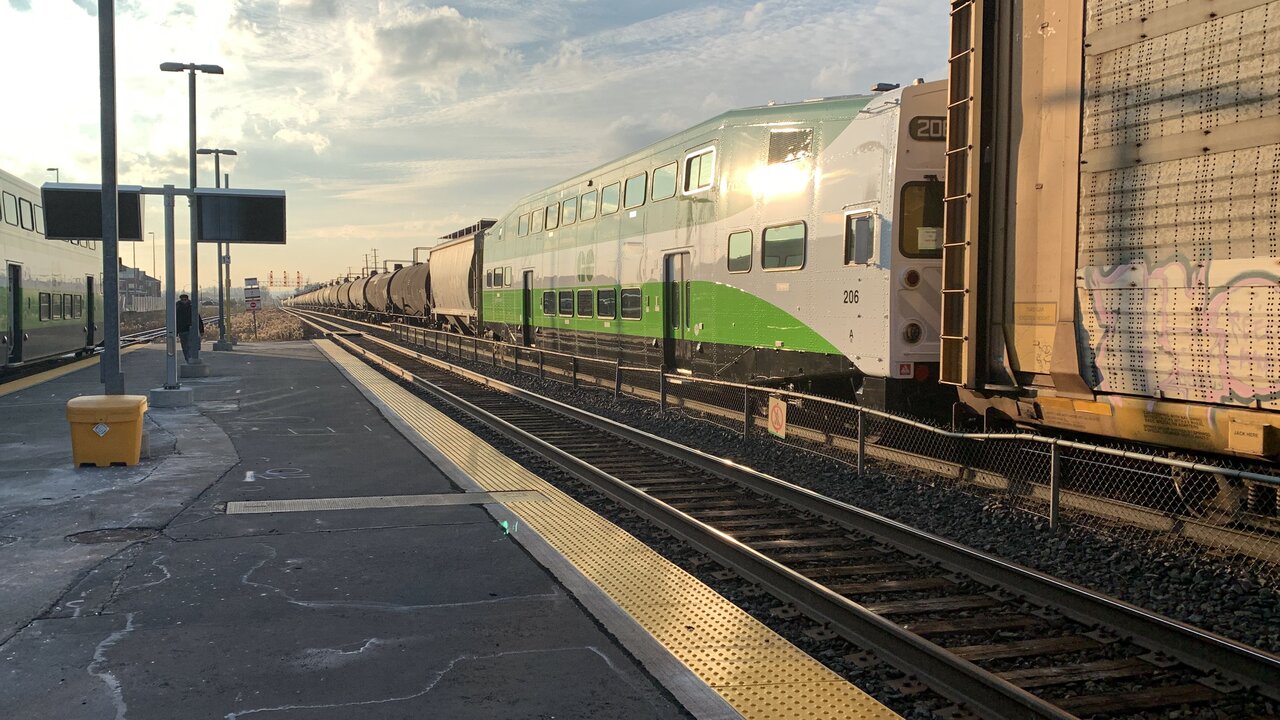

Does anyone know what these two extra vents were for on the first Bi-Level series? Today they're covered up and I don't think they were used for that long, and I can't find any information on them.
