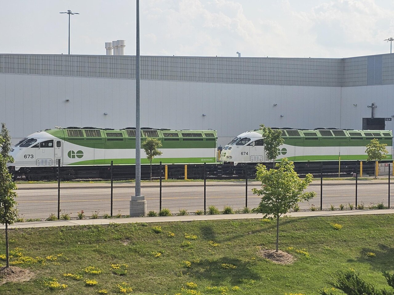

July 31 - On a different note - seen outside the Whitby GO Transit Maintenance Facility today:
I'm not shocked by GO Locos outside their east side maintenance facility...........but the idea that you, AHK can be found in such a place is astonishing indeed!
