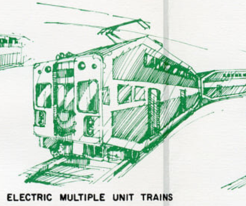

this could actually work well for GO to get cheap multiple units without mothballing everything. rebuild/order bi level power unit cars so that every 3rd or every other one is a power car and book end the cab cars.
hopefully DB will consider this option. this is essentially EMU conversion using the existing fleet.

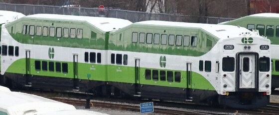

^There have been lots of inexpert suggestions over the years that the traditional GO bilevel model is compatible with a EMU or maybe DMU configuration..... and lots of artwork from consultants who didn't have to build, maintain, oroperate same.... but I'm not convinced that anyone ever asked a PEng if it was feasible or desirable.
Seems to me that the design has maxed out the interior space (ie passenger capacity) at the expense of underfloor space and/or weight carrying ability. So to my layman's perspective, the design might be a terrible starting point for a self propelled car design.
I would speculate that when GO seriously contemplates self propelled cars, (as they should) they will land on a different design that is purpose built for that operating and maintenance mode.
The last thing we need is for a builder to cram electrical or diesel components into some disfunctional arrangement that is hard to maintain or pushes the envelope on stress factors for the car. So my bet is, the bilevel fleet ends up behind electric locos or mu'd to some new power equipped railcar.
There's a difference between how professional designers think and those who just say "wouldn't it be neat if....."
spitballing some creative armchair ideas, since the 2 levels and diaphragms are connected via the mid landing on either side, maybe they can still keep the bi level body and house all the power equipment on the lower deck and block out access.
or they go the FLIRT way and have a passageway through the powerpack car. maybe a retrofit isnt possible but using the existing body with a strengthened frame on a new build is possible.
