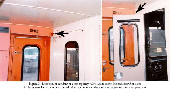

Since it doesn't seem to be clear - the cab areas of the cars have had several iterations over the years.
As built, the cab allowed for only one crewman, the engineer. On the othe side of the car the seats backed against the solid wall, and the conductor would sit in those two seats. As seen in those photos, the cab doors originally opened outwards, blocking the end doors of the cars.
They then got a rebuild in the early 2000s, and had the second window placed there. The seats that backed to the wall were removed and replaced with a pair of seats the faced the window. But that area was still kept open for the public to use when the cab was trailing the trainset, or if it was marshalled in the middle. Around this time (or maybe even earlier), the cab doors were modified to open back into passenger compartment and latch against the cabinet behind the cab, rather than blocking off the end door (and more importantly, the emergency brake handle).
That only lasted a handful of years. A partition was put behind those two seats, and the door to the cab door was modified to allow for the entire front of the cab car to be blocked off by latching into the partition.

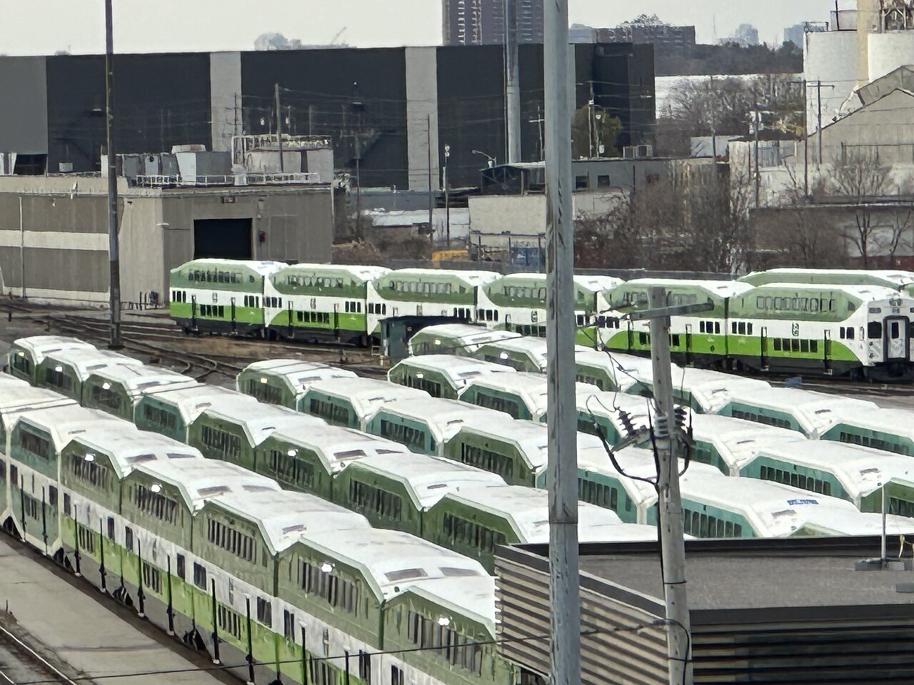

i'm curious what percentage of old livery painted cars are left in the GO system?
I’m assuming less than 40% as from what I’ve seen it’s only the non refurbished Series II cars (which are all OOS), all the Series III and IV cars, some Series V, some Series VI, some Series VII, and most Series VIII cars.
I don't have any percentage figures, but from my observations of late, the following is still in the old colours:
-everything from Series II except for the infamous cab cars (56 cars)
-everything from Series III (62 cars)
-everything from Series IV (59 cars)
-22 coaches of Series V
-everything of Series VIII except for 2808, 2838-2857 and 2555-2560 (which would make 155 cars in the original colour, if I have put my figures through right)
That means 354 cars minimum.
Then there are still some coaches in the Series VI and VII group that are still in the old colours, but they seem to be getting repainted at the moment. No idea how many should still be left. This number includes any cars which are stored, as I'm not aware of any roster tracking that at the moment.
EDIT: Apparently there are no Series II coaches in service right now, as observed above. This is one disadvantage of having to edit all your photos RAW, it can take months before a whole batch is completed and you can tag it with fleet numbers, and you miss a lot of patterns.
Thanks. That looks like a reasonable vantage point, perhaps my complaining will be answered...
