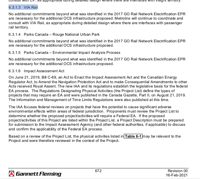

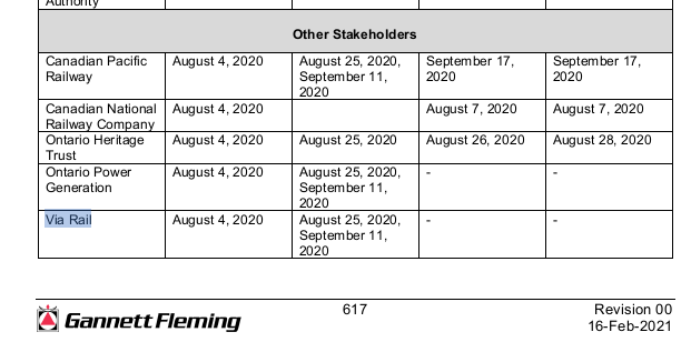

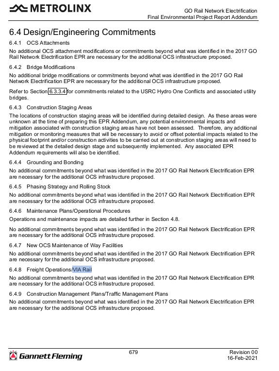

If you look in the 798-page addendum, there are references to meeting with VIA Rail.
