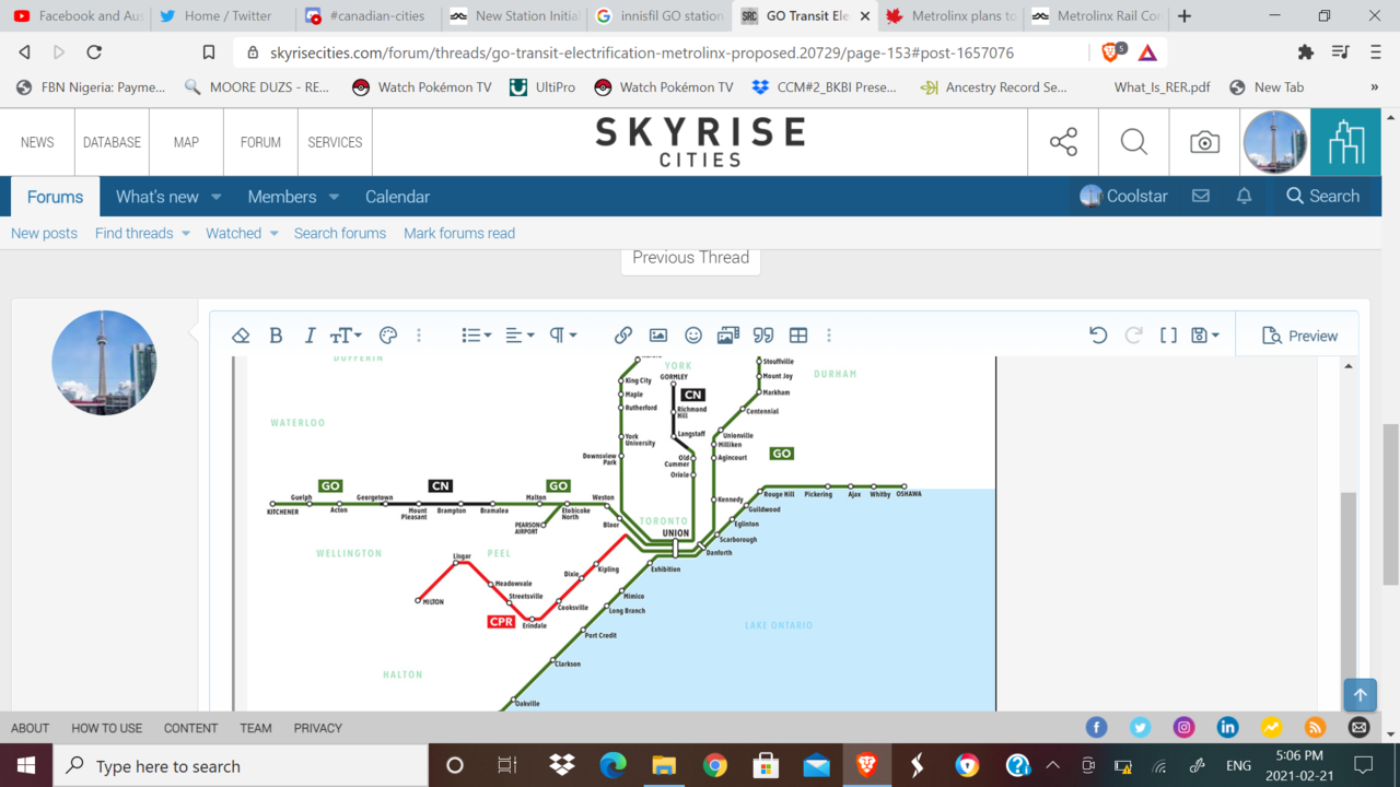

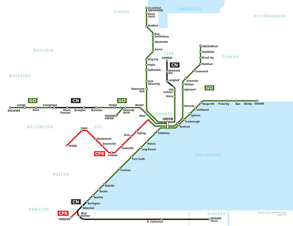

The only thing that stood out for me was that all the maps had RER ending at Burlington. I thought RER was suppose to go all the way to Aldershot?
CN owns the track beyond Burlington GO. Metrolinx is only electrifying the corridors they own.

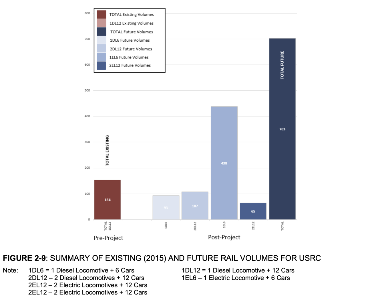

The detail on LSE is bizarre. On Page 55 they specify 95 revenue diesel hauled trains per weekday, plus 70 non-revenue diesel hauled trains. That's almost one non-revenue move for every revenue move.
But then, Barrie (pg 52) specifies 232 revenue electric trains and 130 non-revenue electric trains. Won't the folks around the Davenport Diamond be thrilled to learn that a third of the trains traversing the new flyover will be empty!
I was going to respond about the Stouffville number with a sarcastic "Must be Smart Track". But maybe that's the reality?
Why are there non-revenue trains at all?
Well non-revenue trains usually means moving out of service trains... somewhere, usually to a layover facility.
It begs the question of what exactly is defined by non-revenue trips. If you have to move a train from Allendale Waterfront to the Bradford Layover Facility, does that count as a non-revenue service? This could mean the number is inflated by a ton of extremely short service trips.
That's a good point. If the diesel trains are peak service, there could be four equipment moves per day for every trainset. One to position for the morning service, then say three revenue moves, then a non-revenue move to layover. Repeat for the afternoon peak. That's 4 equipment moves for 6 revenue moves. The numbers could look even worse if a trainset's service profile has a deadhead turnback between two revenue peak trips....6 non-revenue moves for 4 revenue moves. We would have to know more. The location of the service yards is a bit odd, especially Midland, and that could inflate the equipment moves.... but better to deadhead to Midland at day's end instead of going all the way to Willowbrook or Whitby, I guess.
Nevertheless, the Stouffville Line number is surprising. I would have thought LSE/LSW would be in the same ballpark.
With Lakeshore East you still have to move trains from the Eglinton/Guildwood Layover facility (wherever it is) to Oshawa to start the day with those peak hour services, so same ideas apply.
