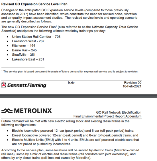

The EPR addendum for GO electrification is up!
Seems to be a new service level plan though I can't remember what the previous plan was.
