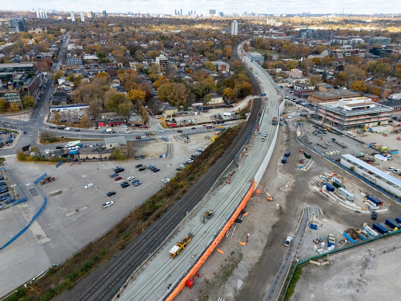

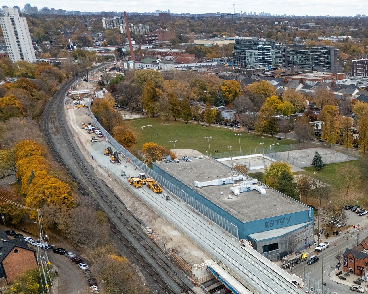

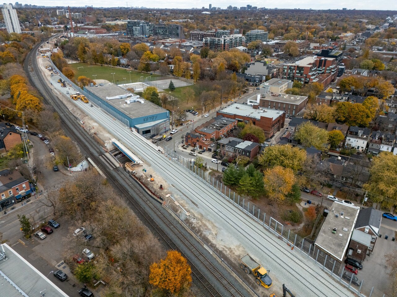

Some shots of the Lake Shore East Corridor ahead of this weekend's track shifting. Third shot shows where the new tracks will eventually merge back to old tracks. I read in the community notice that the new tracks are only temporary, which seems odd to me. Is there more shifting that has to occur? I thought GO tracks were going to stay on the South & East side of the corridor.
Great photos! You can see the last gasp of the old Riverdale station platform, that will seoon be gone for good!
I'm surprised that they are shifting already before the Dundas and Logan bridges are done. So there'll defininitely be a shift there. And at Gerrard/Carlaw when they start working on the station there.
At the south end, they must be into the track for East Harbour GO; maybe they'll have to do another shift there?
