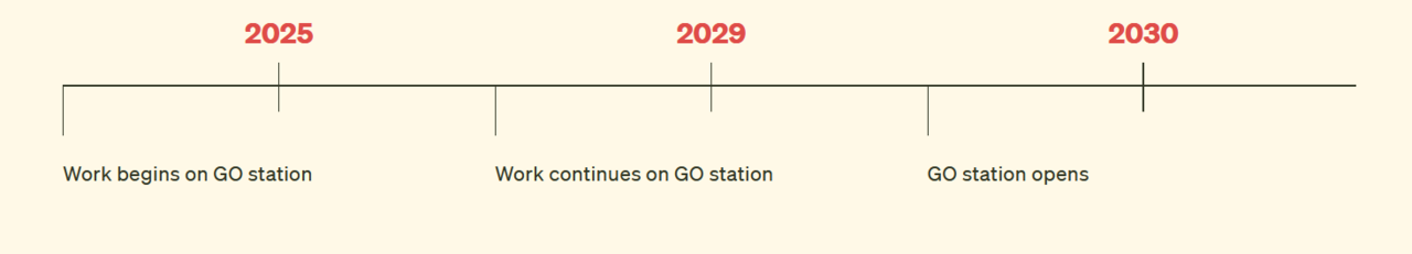

https://woodbinecommunityplan.com/#timeline

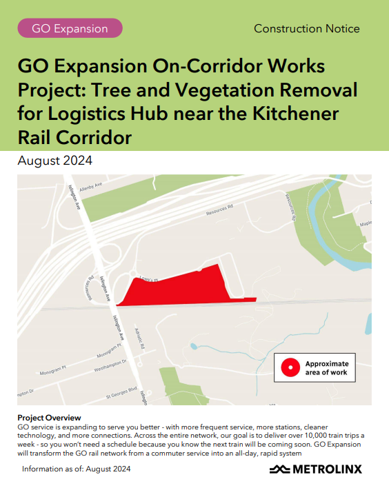

Someone on the Discord server for More Transit for Southern Ontario (in the general thread) posted this:
The interesting thing about this parcel of land is that it was originally acquired for a EMU maintenance facility for UP Express.
It never made a lot of sense to have a separate maintenance facility for such a small fleet..., but with ML's plans for a broader electrification having overtaken things, a MOW base makes a lot of sense.
