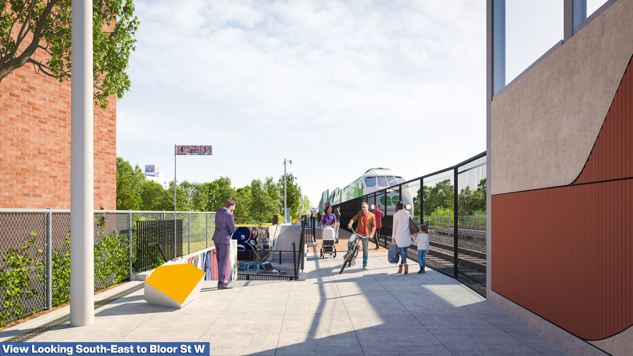

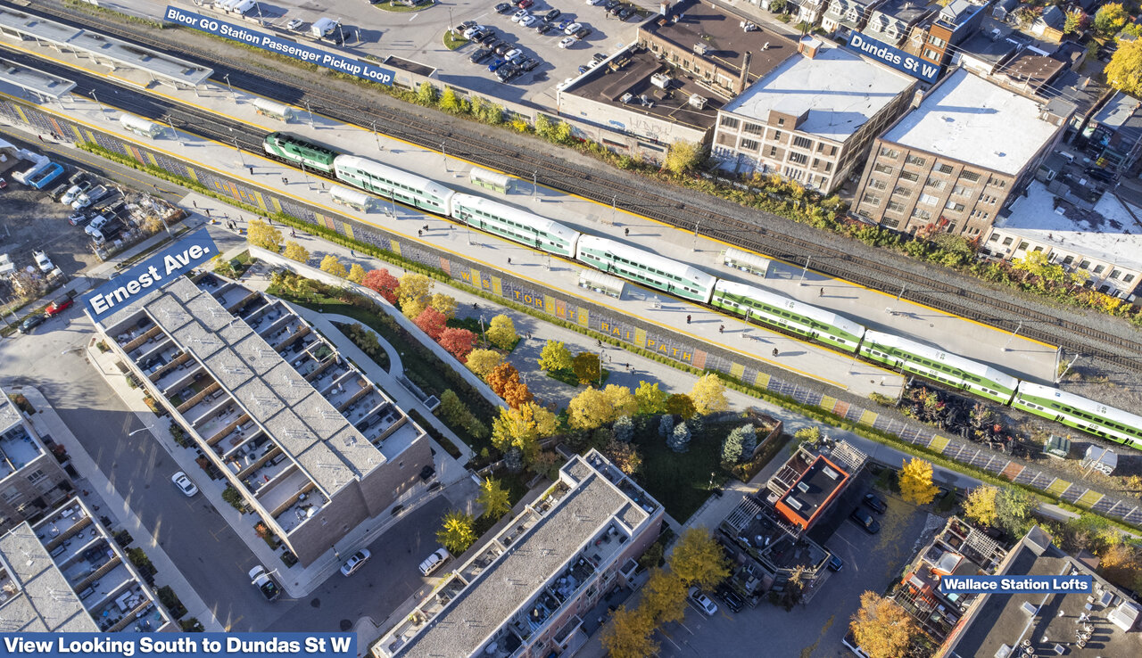

Appears to be new renderings for the Kitchener Line 4th Track/Bloor GO Station in this tweet.
Text:
We’re shifting to the #KitchenerLine for Day 4! Currently, we are adding a fourth track along the line in #Toronto—by #BloorGO Station, between Lansdowne Avenue and Dupont Street.
When complete, this transformative work will enable two-way, all-day service! 🎉
Text:
It's so great to see this station finally nearing competition after being truncated to meeting the 2015 Pan Am deadline.
