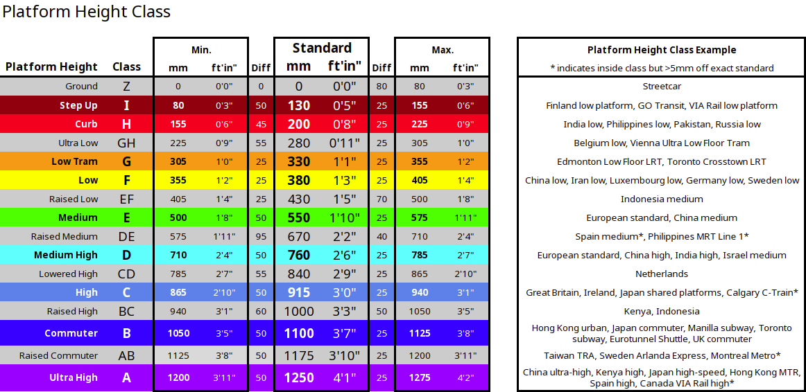

The common standards for rail platform heights are 130mm, 380mm, 550mm, 760mm, 915mm, 1100mm, and 1250mm.
Railway Platform Height Table
Those are standards for new construction.
The possibility of all platforms in a given country being upgraded to these standards is very small, however.
And what would we have to gain from choosing a standardized height? As demonstrated in Europe, dropping a floor or moving it upwards a few centimetres is hardly an insurmountable task. Coupled with the continued existence of the BiLevels, I would think the most logical solution is to keep the height at 610 mm.
