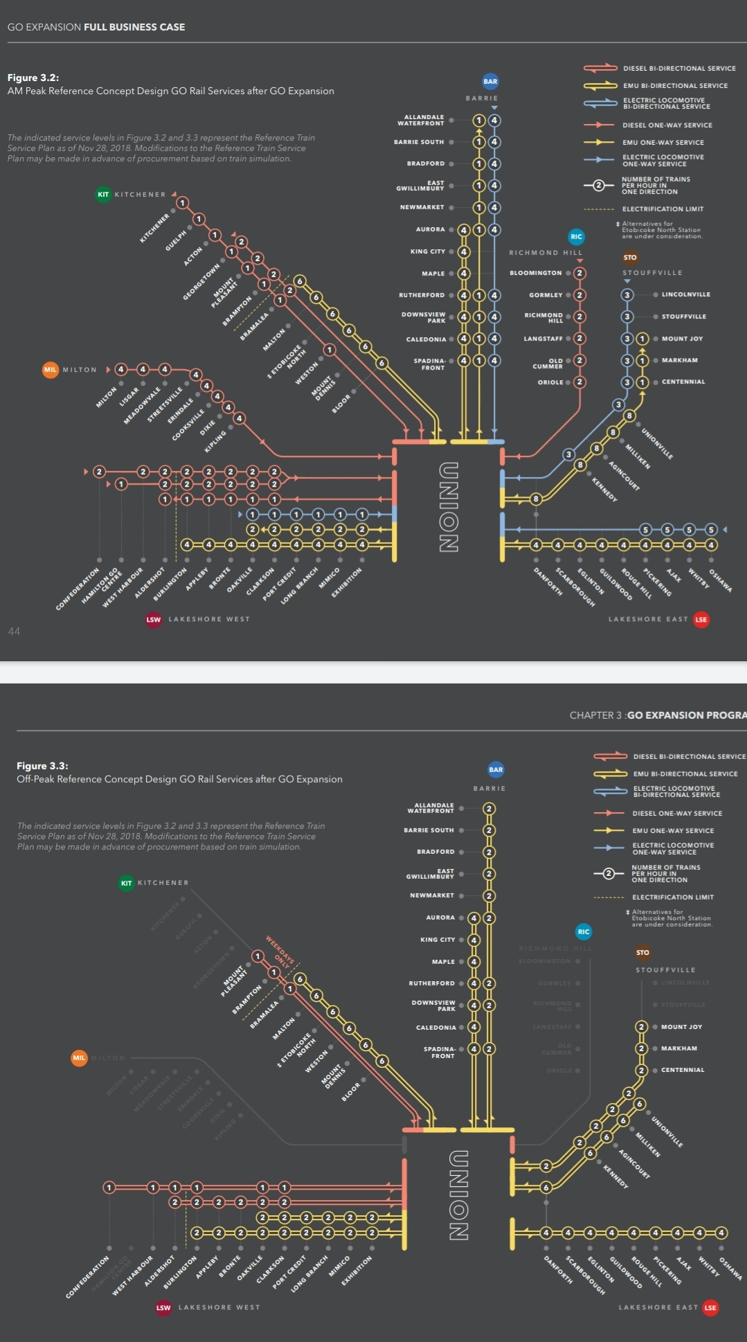

Metrolinx hasn't mentioned it but they have gone to significant effort to ensure it is an option for bidding based on discussion with short-listed bidders. Commuter rail electric locomotives are quite cheap and most existing GO rolling stock is usable for several more decades.
There will still be a need for a lot of the existing bi levels on the express network though. With 4x the service they will still have to buy a lot more trains. It would be foolish to buy more bilevels.
I assume there will be some service with electric/dual mode locos and bi levels, and then the rest with EMUs.
I expect Kitchener/Stouffville to be the first through line to run EMU's at the beginning, because of the station spacing and need for EMU's to replace the UPX and fulfil the SmartTrack stations requirements (many stops close together in subway-like style). Diesel bi level will run express to Kitchener west of Bramalea to fulfil the all day Kitchener in 90 minutes. (has to be express to meet that goal)
Lakeshore and Barrie will get Electric/Dual locos at first pulling the existing bilevels. Since Lakeshore can already operate at 15 minutes or better with the current fleet, and they can electrify all the way to Barrie and just use one train all the way. In the future Barrie will be replaced with EMU's as the fleet ages, and potentially Lakeshore but will need to continue to run Bi Levels as express service to Niagara/Bowmanville.
Richmond/Milton will exist as is. No change.

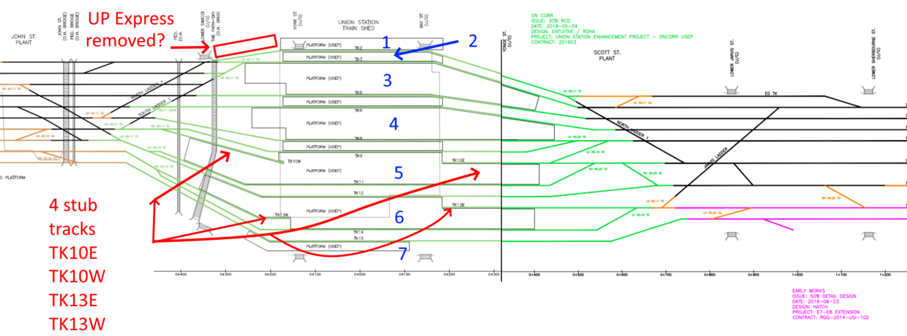

My uneducated guess for the 4 stub tracks TK10E, TK10W, TK13E, and TK13W is for VIA departures; and potentially other express train departures depending on the platform length. VIA arrivals can unload relatively quickly and then pull forward and back into the stub tracks as they prep and wait for loading as departures.
Thanks. Will update it and repost later.

Well according to the IBC, Electric Locos if bought will be used for extra rush hour trips on electrified corridors (This is from 2019)
While the plans could've easily changed since then, I feel like this is the most sensible option for rolling stock reuse. Make most of your investments into EMUs, and then get a couple Electric Locomotives for additional trains you need during rush hour, and use them in conjunction with the older bilevel coaches.
I'm assuming that the electric locomotives are only step one for electrification. Can see future versions be like the subway cars without using locomotives, with pantographs instead of third rail.

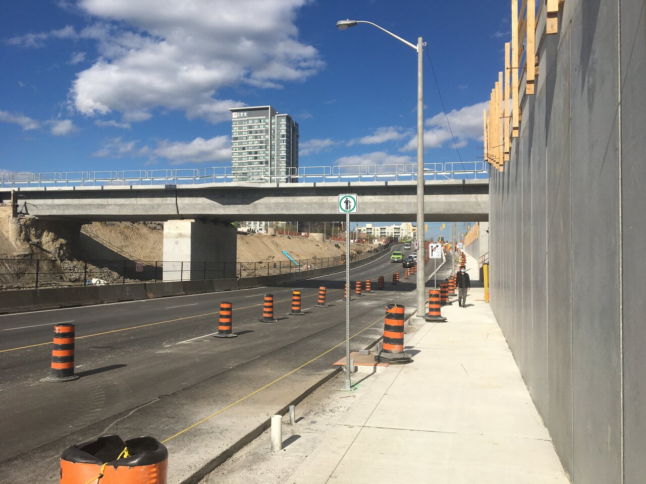

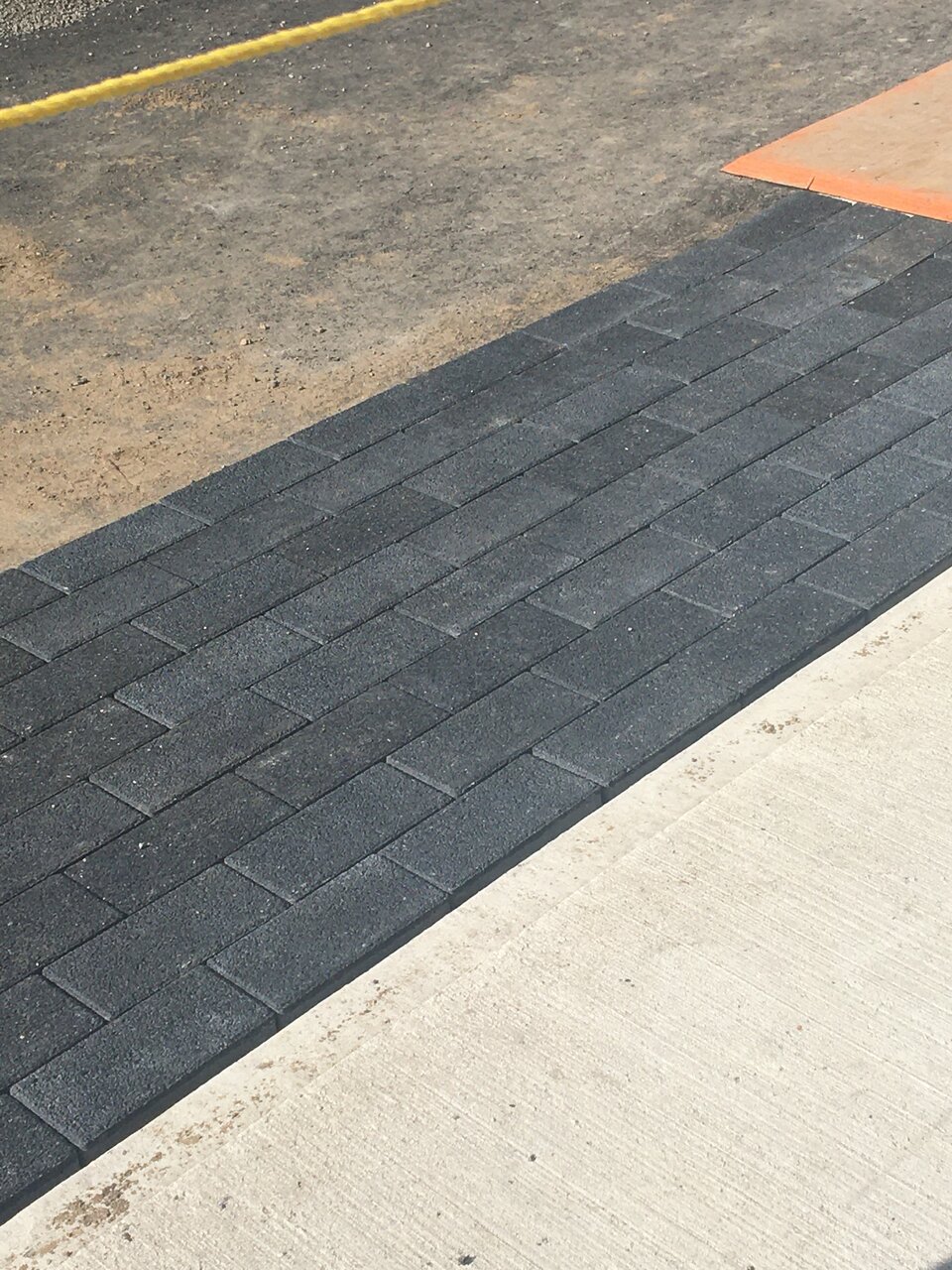

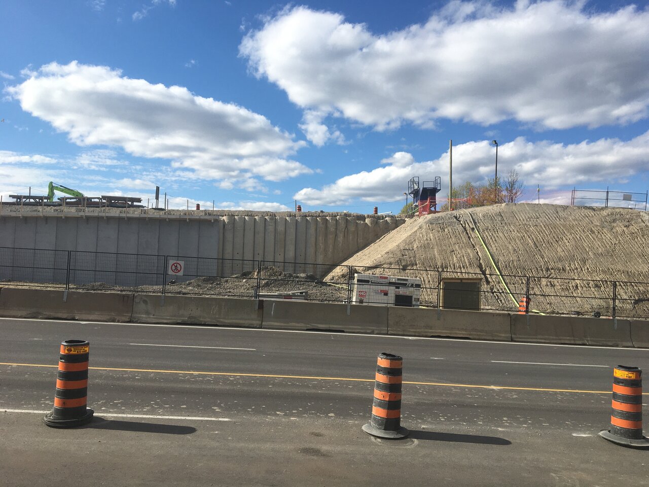

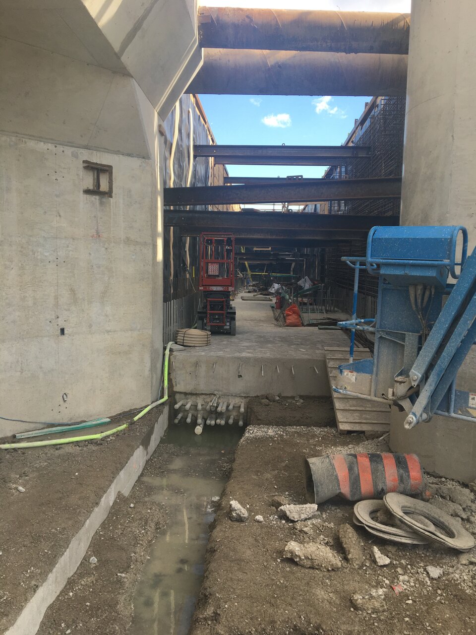

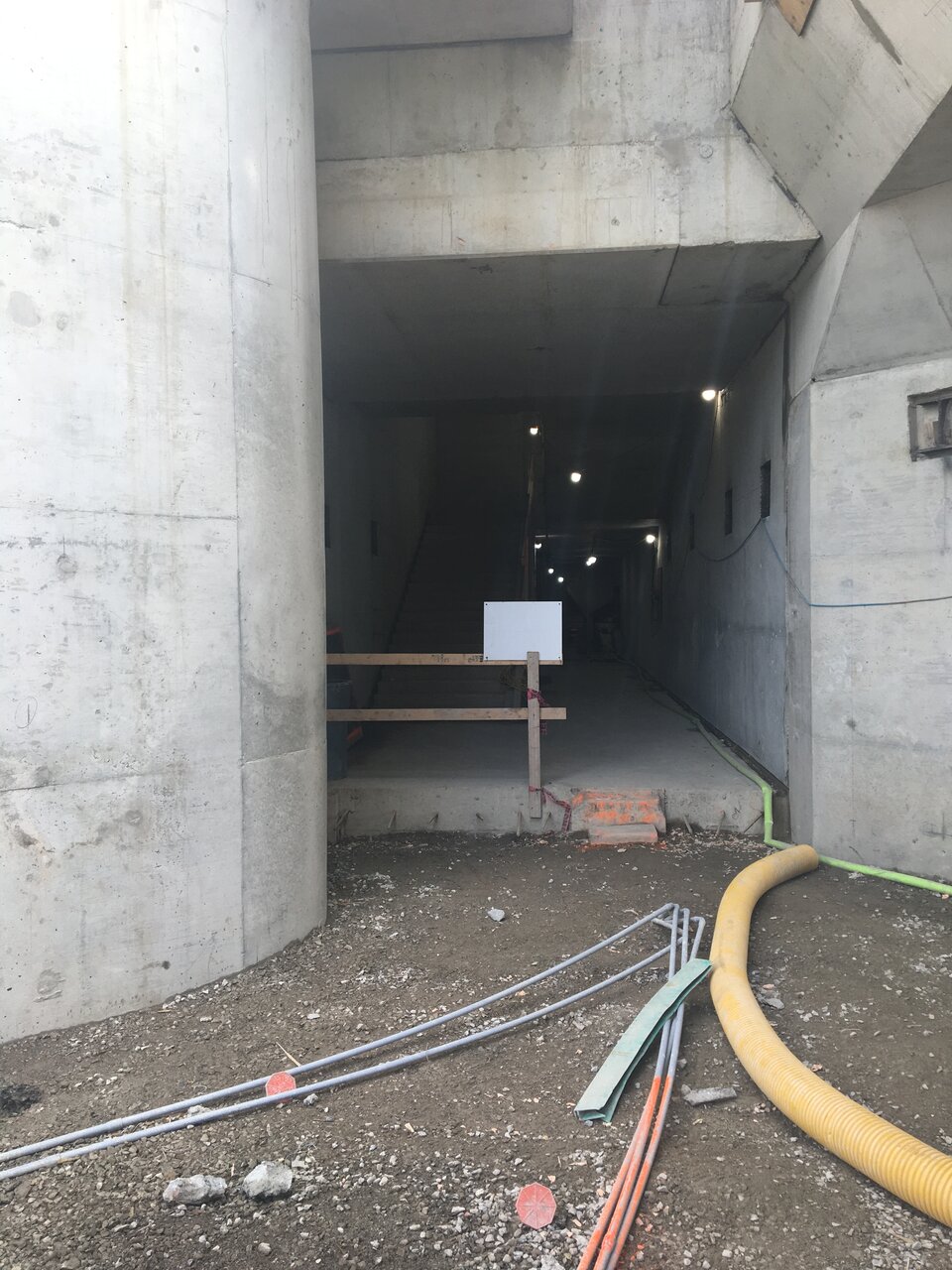

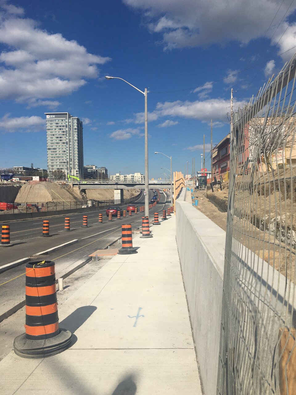

Just a quick construction update at Milliken GO. Formings are progressing for the north side of the underpass, aswell pavers are going in between the bike path and the sidewalk. There was much larger pavers on site aswell, I assume for the bike path but it could be for something else.
