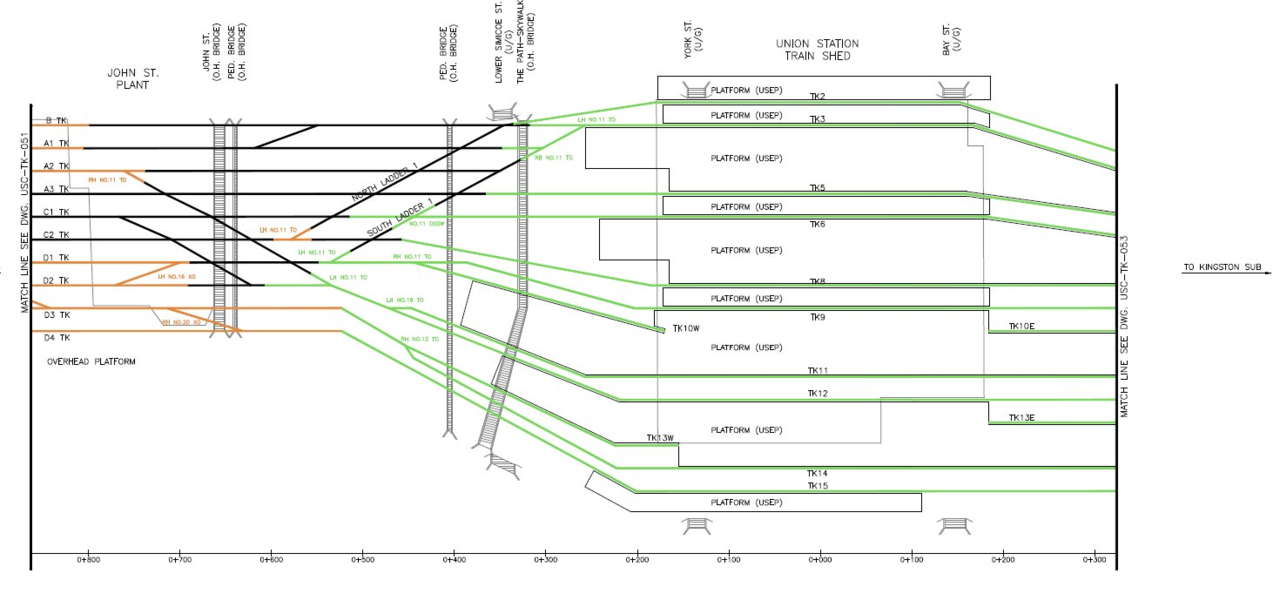

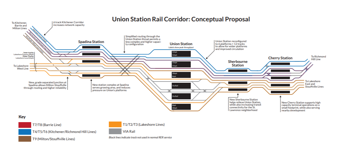

If they are expanding tracks here, won't they also need to expand tracks further east after Lakeshore West line merges? Otherwise that will become a choke point. I don't see any space west of Union to add more tracks.
That's why ML has been noodling on how to rearrange platform allocations at Union to maximise the throughput through the ladders and flyover between Union and Bathurst Street. Several ML documents have shown different layouts and I don't know if there is a final official version. Having the tracks narrow from 8 to something less on the Weston corridor, and merging with the four from the Oakville corridor, isn't a problem per se... provided the number of moves requiring crossing over is minimised.
This is the most recent layout I've seen. Not sure if you've seen this one. This is from a noise and vibration pdf released back in December. Pg. 88/89 to save you the trouble.
Edit: Added in the TRBOT proposal for comparison.
