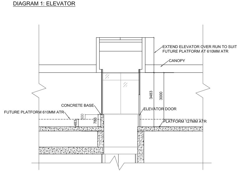

This is poor design and lawsuit inducing:
Looking at the above image, I suppose that all that GO's new higher platforms would accomplish for VIA is to eliminate the stepstool. That would streamline their operations a bit, but it would still be a far cry from actual level boarding with automatic gap fillers.

Now you are coming up with crazy concerns. Every high-speed train in the world is high-platform, the vast majority of subway lines are high-platform. The most common reason for not having high-platform is a legacy of putting freight before passengers on railway lines, or a need for routes to support curbside on-street stops like pre-metros, River Line, etc. Despite Metrolinx running the show and having an entire network of low platforms, it built UP Express as high platform making it necessary to build two platform heights at Bloor, Weston, and future stops. Clearly even Metrolinx sees the benefits.

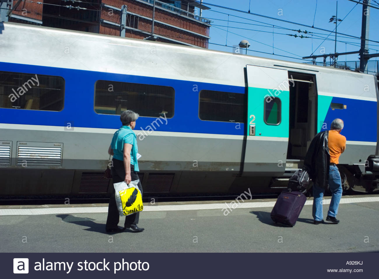

You're actually incorrect here, here's a TGV:
