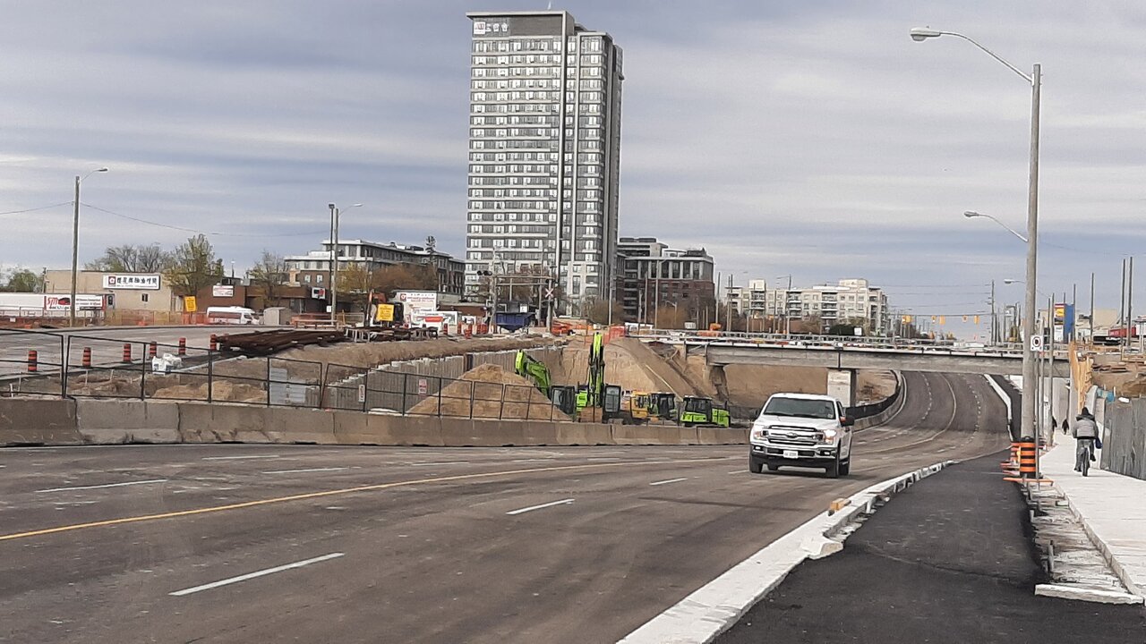

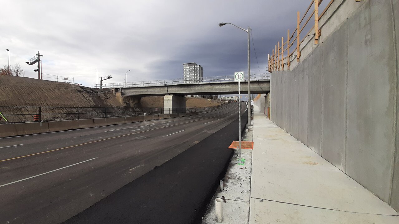

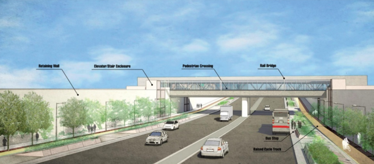

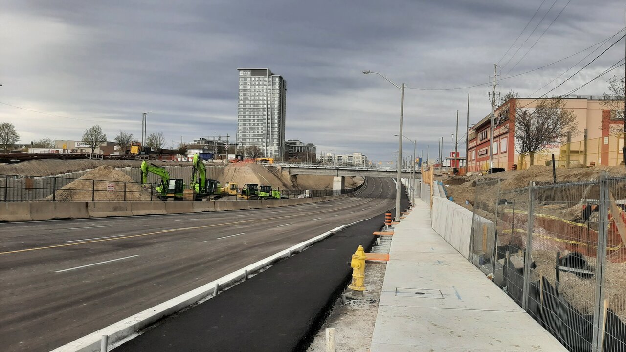

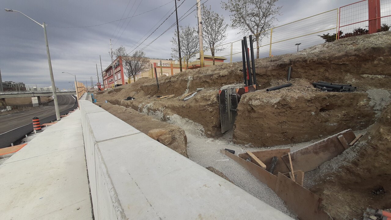

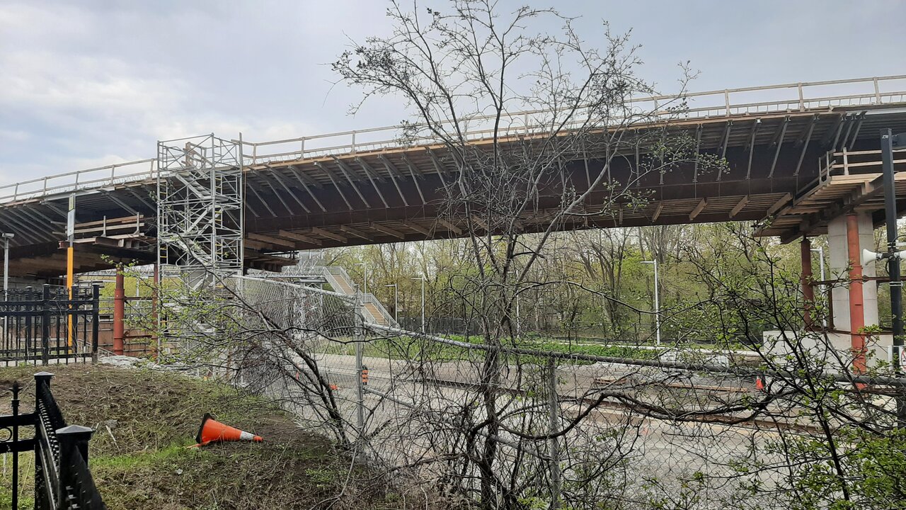

Steeles grade separation from today:

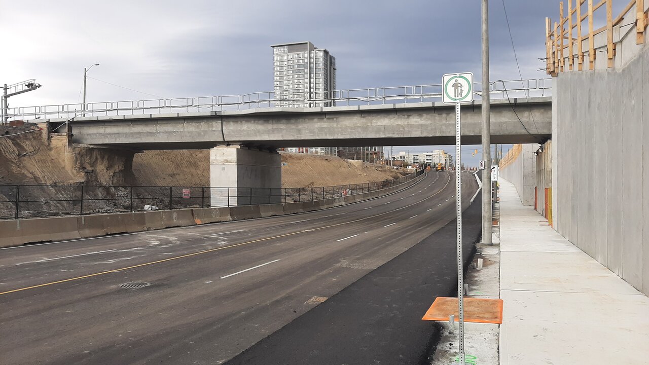

The above does not seem to reflect this render:
Looking at how much space there is between the support pier and the side wall; hopefully the final product will look more like this.
Though, if that's the case, they are going to have to rip a lot of asphalt back out...........which seems a tad wasteful.

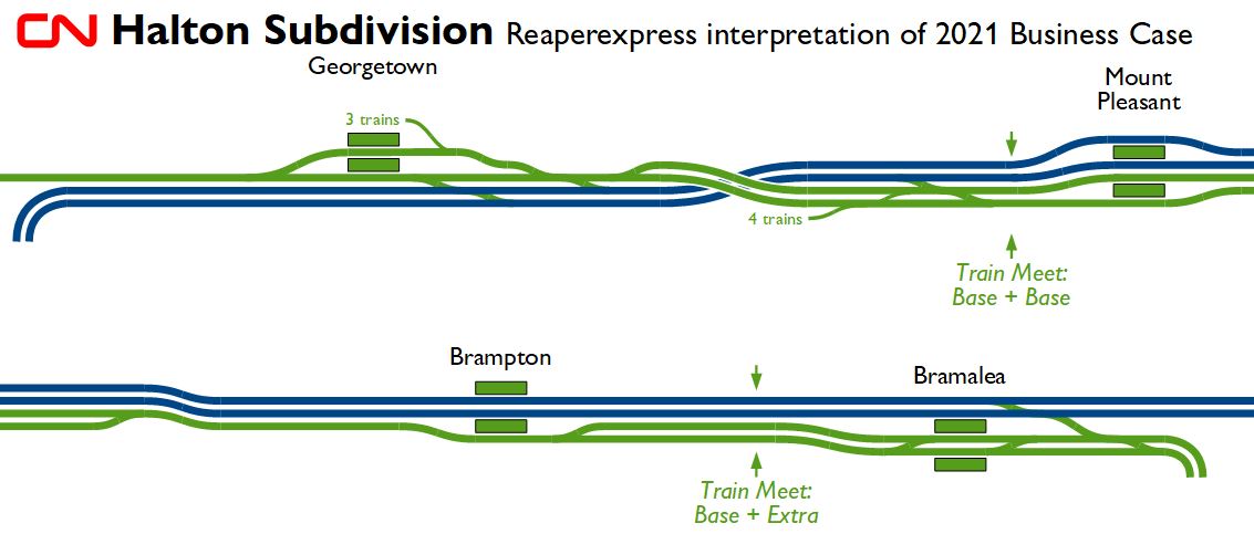

Reading the report (p.50), trains in opposite directions meet at Georgetown GO, not west of Georgetown GO. Therefore, the departure time in both directions at Georgetown GO should be the same.
There are benefits in meeting at Georgetown GO as the train can choose to crossover the CN tracks before or after the station, which increases the chance of a clear crossing path. Here is an oversimplified diagram:
^@Haydenpoon’s layout would allow an eastbound GO to wait at the north platform for the westbound to arrive at the south platform, or the westbound to wait on the south side for the eastbound to arrive......then both trains could cross over simultaneously, minimizing the interruption to CN.. I think this is the most likely layout for the no-overpass scenario. One could envision fixed (diamond) crossings as opposed to turnouts being used to cross CN.
The added 8 minutes in this option reflects dwell time for both trains in the station, partly to ensure both trains are ready to cross together, and also possibly to give time for any CN train that was already passing to clear the crossovers.
The fly in the ointment would be the need for eastbound CN freights to hold west of Silver if the GO trains were lined. This would block a couple of very bust road crossings, and potentially stop the freight on a grade. I suspect CN would be happier to have the crossing over happen at the Georgetown crossovers, a little further east and with any held-up eastbound trains a bit less hampered by grade.
Good points, guys. I was somewhat dubious on the prospect of swapping platforms in real time, but I suppose if they anticipate the blockage far enough in advance, there could be enough time for waiting passengers to swap platforms.

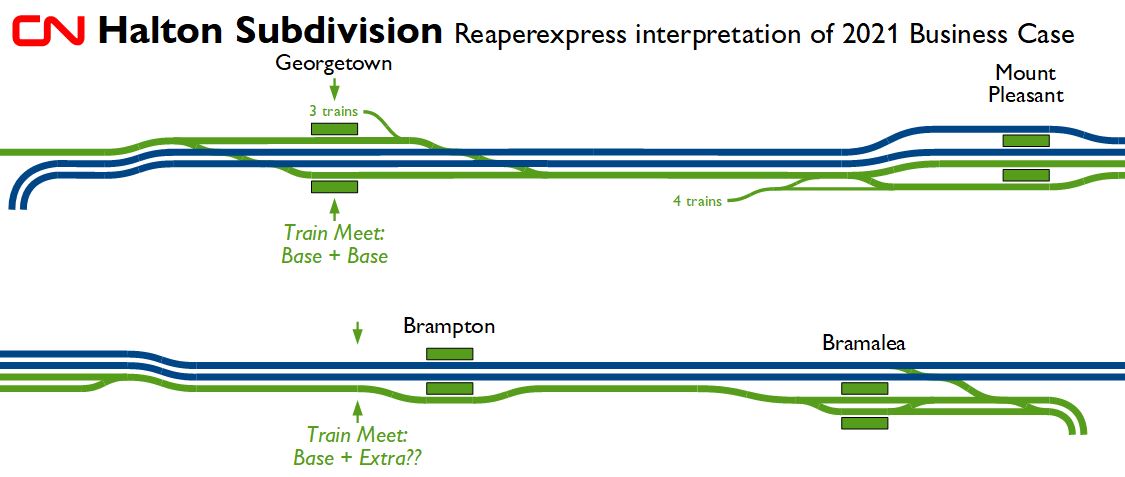

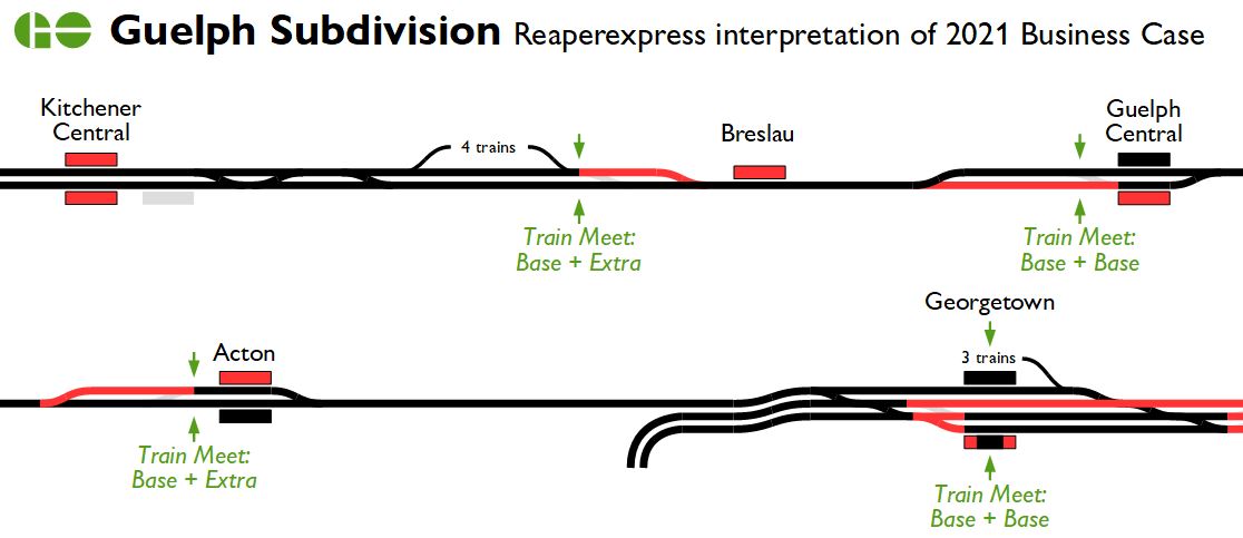

Here's an updated scenario to reflect this:
I don't think diamond crossovers would be suitable at Georgetown, because CN local freights from Kitchener, VIA trains, and counter-peak GO trains need to be able to go from the Guelph subdivision to either of the CN tracks.
As you'd imagine, all the meets shift a bit to the east compared to the previous version. In most cases this is inconsequential, but it does seem to place a meet between the off-peak Mt Pleasant - Union service and the base hourly service at Brampton Station, which is not somewhere I'd have guessed they'd build a passing track. Maybe my estimated travel times are a bit off, or maybe they will run uneven headways between the base and off-peak 'extra' services to line up with the passing track locations, or maybe they are planning to quad-track Brampton Station. There are simply too many variables for us to make accurate predictions about the track layout or scheduling on the Halton Subdivision.
Second, a question, is your assumption on VIA based on existing frequencies and times?
As I recall, at one point, VIA was contemplating up to 8 frequencies daily to Windsor; presumably that would be more challenging than the existing pre-Covid schedule.
Yes, my assumption was VIA frequencies would be similar to current, around 2 to 4 per day. At that level, it seems plausible that CN would accommodate a large enough train path for VIA to run unimpeded along the CN track (including crossing over at-grade). The more services VIA runs, the less willing CN will be to provide them with a clear shot down the CN-focused tracks. What level of service they'd be able to get away with is entirely up to CN, and I have no idea how much that might be.
Third, do you have a notion as to how much benefit would be on the table w/grade separation (at Silver)
I am assuming that the Credit River bridge just east of Georgetown will be triple-tracked, not quad-tracked, and VIA would probably need to continue to use the CN tracks in order to avoid getting stuck behind a local GO train. So the grade separation wouldn't really make much difference to them. It might maybe save a minute or two of schedule padding thanks to the improved capacity and flexibility, but nothing significant.
If they do quad-track the Credit River bridge to bring the second passenger track all the way into Georgetown Station, then VIA could definitely use the passenger tracks. But then they'd be dependent on GO scheduling a large enough gap between GO trains to accommodate the "catch up" time of a much faster VIA run. This is the downside of "commercially astute" infrastructure planning, it really doesn't leave much flexibility for different speeds of services.
