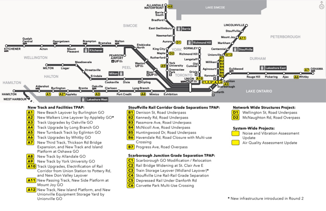

So basically they identified the need for a new layover on the Lakeshore East and West lines. Wonder why - are the planning to increase service on those lines above what they planned in February?
My (optimistic) speculation is that, as the DBFOM RFP has unfolded, proponents are pointing out showstoppers - ie areas of uncertainly or high risk, and/or suggesting improvements to the plan... and ML is tackling some of these off line in the interest of reducing bidders' risk (and therefore their pricing) or project timeframes.
Bidders may have spotted areas where they feel that past EA's were insufficient, and would be unwilling to take legal risks until/unless any t's are crossed and i's dotted with the EA foundation.
The layover yards are interesting - the RFP is long term and therefore the ultimate short-headway end system service plan must be fleshed out. One new objective may be to minimise deadheading especially in the congested USRC area. Fifteen minute service means four equipment moves an hour in each direction for each route just to get started in the morning, without counting peak service or express trains.
I also note A5 - a LSE turnback track at Eglinton GO... hadn't seen that before (or did I miss it?).
You didn't; that's new.
It's not new for the Eglinton turnback track, though the midland layover as part of the Scarborough junction grade separation is new.
No one in the Feb open house can answer me why the Eglinton layover is needed for some reason.
All the numbers are shifted by 1 due to the new layover at Walkers Line
I stand corrected; has to happen once per decade! :p
Where's the new layover proposed for LSW?

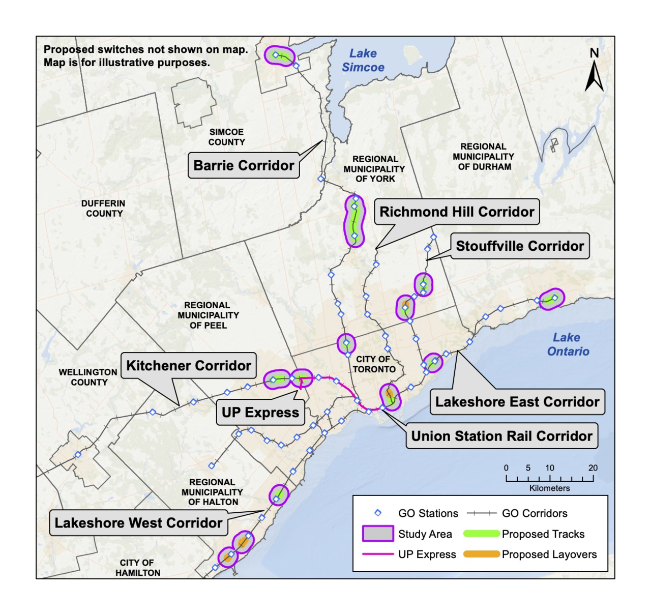

There are actually two. "Beach Yard" is a 16-train facility proposed west of Burlington station:
and "Walkers Line Layover Facility" is a 9-train yard proposed about 1.5 km west of Appleby:
The LSW line could really use some west-end layovers, trains do an awful lot of deadheading at the moment. I particularly like the Beach site: trains would be able to pop out of the yard directly into service at Burlington Station. Nifty!

The one that caught my eye is the "new track around York U GO". The line was already double-tracked in that area a couple years ago (and the station itself already head a second track long before that), so I'm really not sure what that would be about. Maybe they actually meant Downsview Park, which is still single-tracked at the moment? But the map does also highlight the area around York U.
Considering that the Midland layover and Eglinton Turnaround Track is less than 1 km, Metrolinx might just as well connect them together. *The 4th track*
I wondered about that also. We’ve assumed that the contracts already let for beginning the double track north of Davenport will extend all the way to the existing DT that runs north from Steeles.... but I recall seeing a document somewhere that hinted it only went as far as Sheppard. Maybe there was a gap remaining, and this is the fill.
