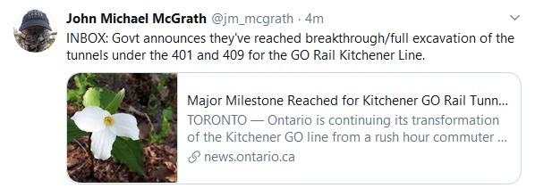

"Breakthrough" is not 100% completion of one tunnel. It's encouraging progress, certainly, but there will be more excavation before the tunnel interior can be completely poured. There will have to be work done to the tunnel portals as well. And then there will have to be grading and track laying and shifting of track from the existing tunnel.
Before any real upgrading can happen on the line, the new Woodbine station will have to be completed such that Etobicoke North can be closed. (The new tracks leading out of the tunnel will run right where Etobicoke North sits at the moment.) Some shifting of local tracks in the Kipling-Martin Grove-27 Highway will be needed also.
Even that will only lead to four tracks being placed in operation from Humberview (Islington Ave) westward to Wice (by the airport). More work is needed west of Wice to add trackage west to Halwest (Bramalea).
To the east of Humberview, the additional Weston Station platform will have to be completed before there will be a full fourth track as far as Nickle (south of Lawrence).
Lastly, the shifting of the Railpath and the Bloor Street bridges will have to be completed, and more track laid, before there can be a fourth track put in service from Nickle to Strachan Ave.
Getting the 401-409 tunnel completed is definitely progress, and an impressive bit of project execution that seems to be running smoothly......but ML seldom manages work with the end in mind. Not getting these other items going will hold up the promised improvements.

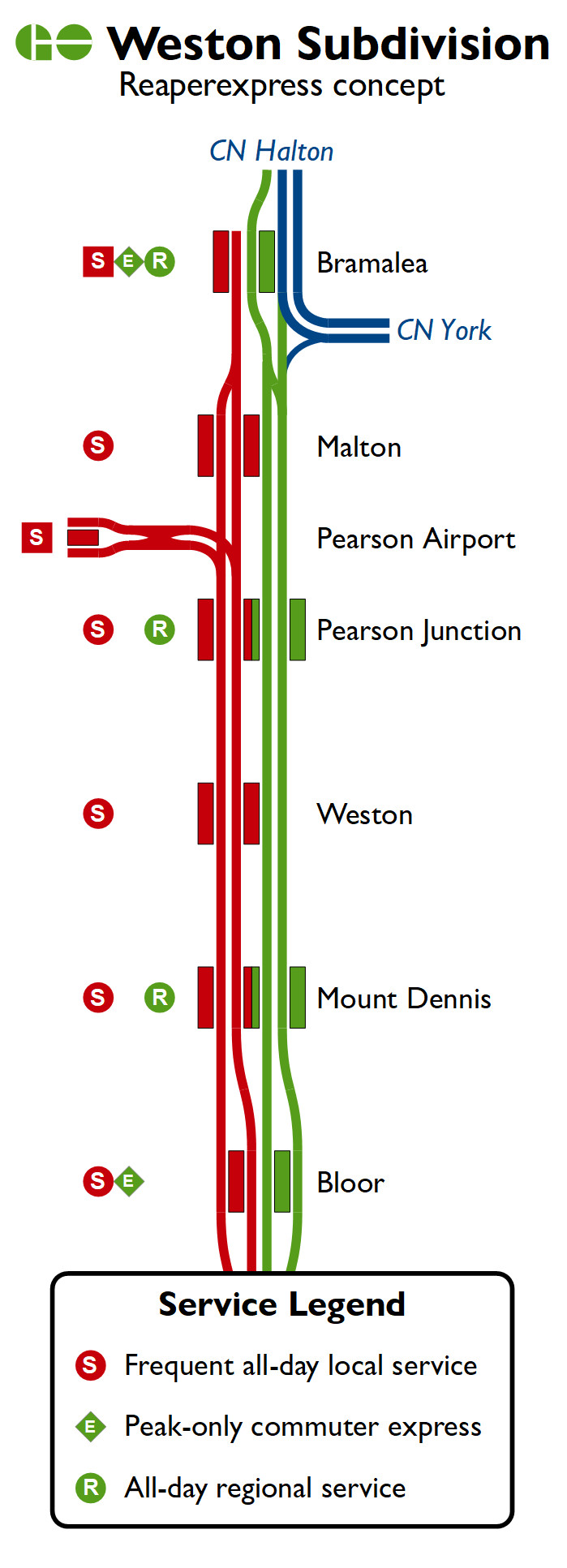

I personally don't think they need to build the north-side platform at Weston station. As services become more frequent it will become increasingly necessary to separate tracks into express tracks and local, since faster trains would otherwise be unable to overtake the frequent local services. The north pair of tracks makes most sense as the express pair, where trains wouldn't stop at Weston anyway:
GO seems to be persuing a layout with a express pair and local pair of tracks, rather than a single quad-tracked line with slow tracks either on the inside or the outside. The dual double-tracked setup is less flexible than a unified quad-tracked setup, but it does avoid the need to build a grade separation at Pearson Junction (Wice).
UP Express, despite its name, is the second-slowest service on the line, and Metrolinx has implied that the new stop at Mount Dennis will be in addition to the existing stops, making it even slower. So it makes sense to be grouped with the GO local services running to Bramalea, not the much-faster VIA and GO express services. It and the local service will also be the least likely to experience delays since they never enter the CN segment. This combination is therefore less risky to operate through the at-grade Pearson Junction than if UP shares tracks with the long-distance services.
Where do you know Metrolinx is persuing express pair and local pair, rather than quad-tracked line?
