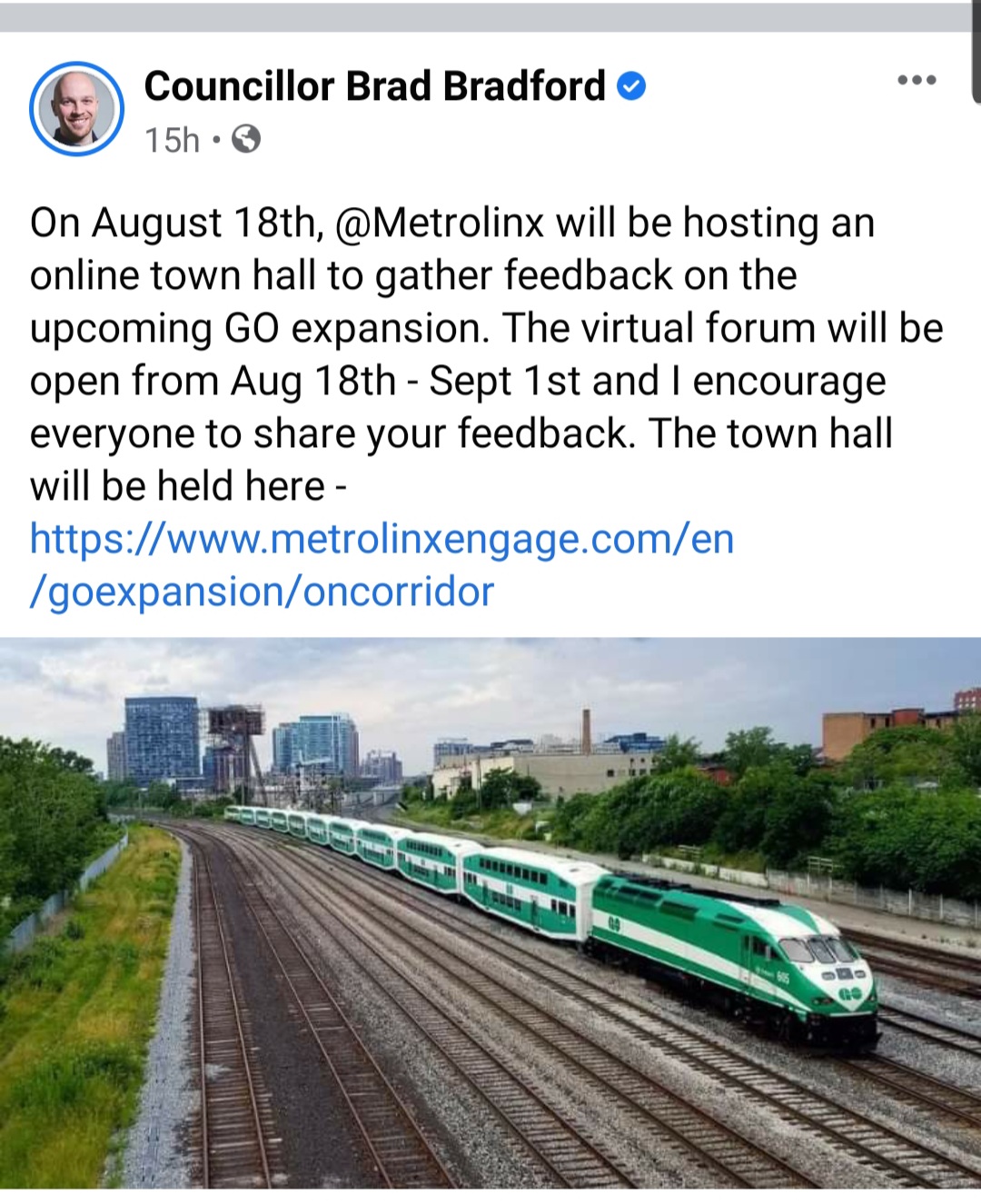

I wonder if a presentation deck will be posted with updates on August 18th?

Round 2 Virtual Open House from August 18 - September 1
