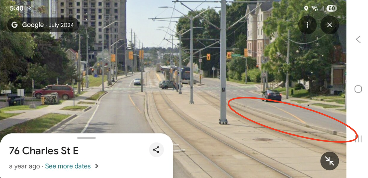

I have yet to see one car lane in each direction for a tram on a raised ROW in a similar winter climate.
Waterloo, Helsinki and Tallinn all have road segments with one car lane in each direction for a tram on a raised ROW in a similar winter climate. What cities did you look at?
Good find, I supposed it was possible. Just wasn't sure where. I looked at Moscow, where trams can be found on non-raised ROW in inner-city corridors. And I meant to say raised median ROW, but I don't think that makes a difference in this case. Either way, I don't think it's very feasible to have 50, 60+ km/h stroads have only one car lane in each direction. Human geography is so different in Toronto.
Also don't shoot me, but isn't the Waterloo LRT not on a raised median ROW in areas that it is in the median? Although there does appear to be a curb separating the tram from the car lane, the tram row itself is at the same level as the adjacent car lanes. I would assume this helps with snow clearing. I haven't ever tried or even seen ION in person.
*EDIT, now that I'm watching video of Helsinki and Tallinn tram, I am not seeing any raised median ROWs like Line 6 Finch West (so far)... Can someone point me to a photo or video?
The median ROW here doesn't appear to be raised to me. The near side almost looks like it's raised, but on street view, switching back and forth between west and eastbound lanes, you can see the far side is actually a thin raised curb on both sides; the tram ROW itself is not raised higher than the adjacent asphalt by any significant amount, if at all.
