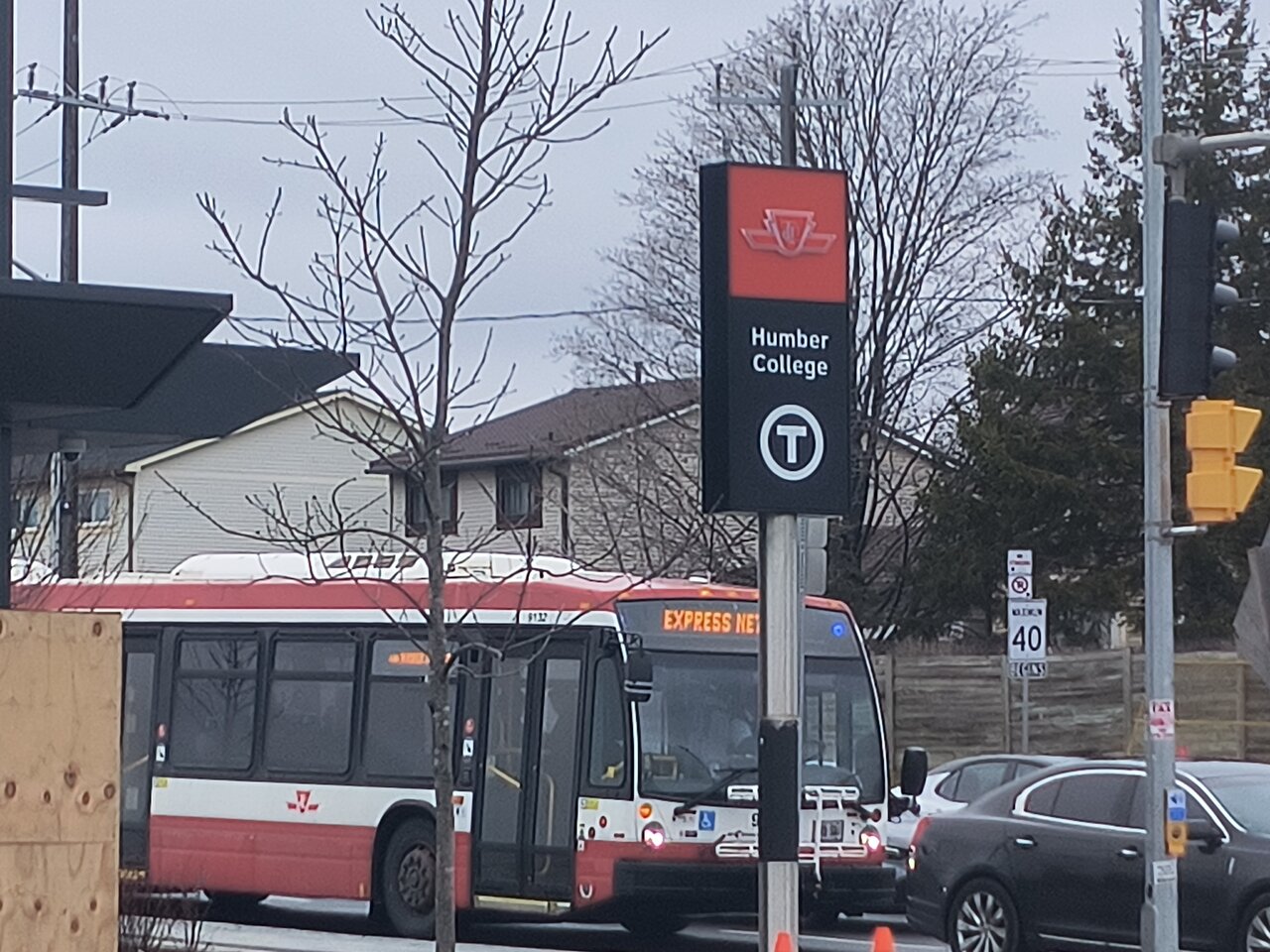

View attachment 642769View attachment 642768
Is the TTC logo 3D?
Call me crazy, but I am not impressed with the new traffic signage either on Finch or on Eglinton. Seems like cognitive overload for motorists, and mostly intended so that the cops can ask, "Didn't you see the sign?" after the inevitable mishap. Too many signs, not well placed, I'm not sure that it conveys the most important message: Don't drive down the tracks! I did see one car misjudge and start to enter the track lane, realised their error and backed out.
Ontario's Highway Traffic Act relies way too heavily on reading text. Are they expecting people to pay attention to the road or to read a recipe for ratatouille while driving?
Is the TTC logo 3D?
It pops out (not flat), if that's what you're inquiring about.
