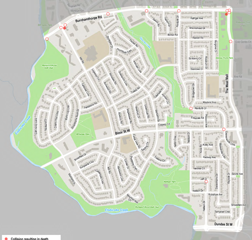

A look at the collisions panel for meeting tells a very clear story:
Circles are collisions; filled in, circles, fatalities. Very clear Burnamthorpe is THE big problem in this community. Other places to make improvements for sure. But to save lives and limbs.....that one is tops, 9 /13 collisions involving serious injury or death, both of the fatal ones.

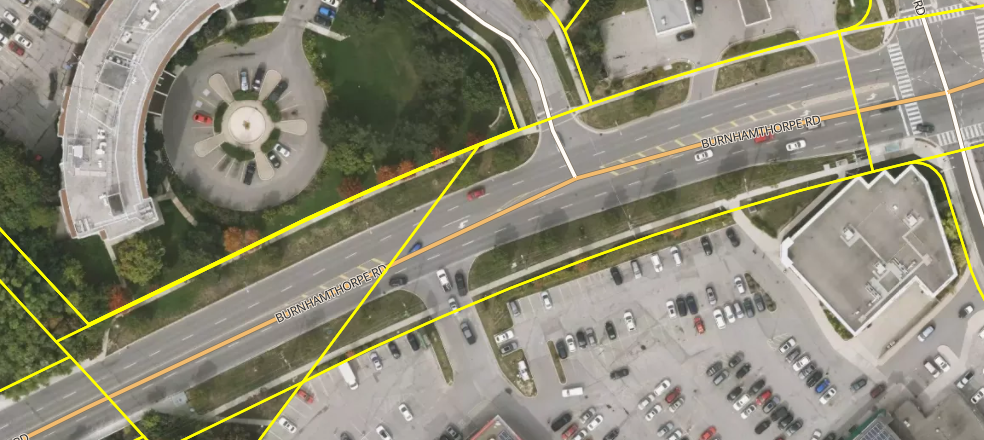

One small idea gets my attention, extending the formal, paved multi-use path down to Bloor here:
(existing MUP in green)
Mill road also looks like an interesting option for a cycling facility, it typically runs 9-10m wide but with only 2 travel lanes. An on-road facility (w/o touching the blvds) would make no parking allowed, but on much of the road, that doesn't seem like it would be an issue.

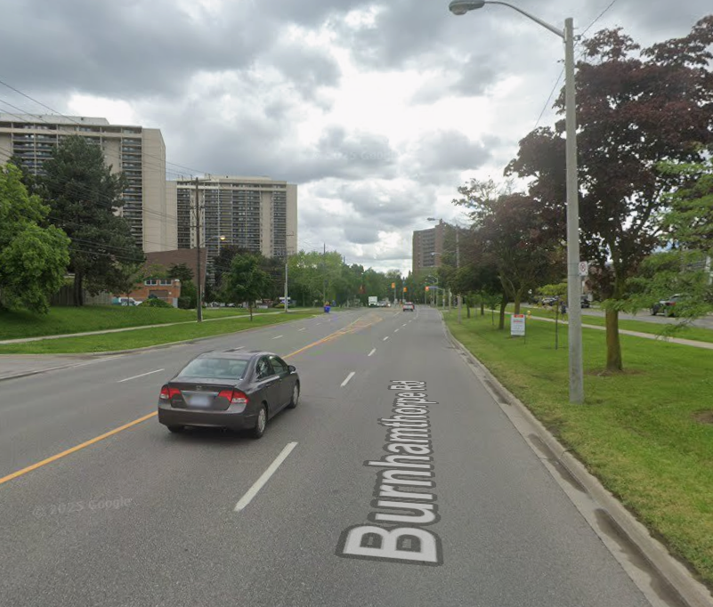

There's room, but not in the curb to curb ROW if you don't take lanes away. (for the most part, there is a really wide bit around Mill).
But if you look at this bit near Elmcrest:
Yes, the boulevards are wide, but when you map it through, you're going to have to remove the trees closest to the curb (there is room to replant), but also you're going to have to move the street light/utility poles.

On the approach to West Mall (from the west), this is what the ROW looks like:
Pink is the property line. Between the two you have 26M of play.
The curb lanes have to be 3.3M, the interior 3M. so you need 13.2M minimum for the road surface.
That leaves lots of room! But, the sidewalks have to be 2.1M each according to guidelines. That cuts you down another 4.2M leaving 9M, still good, but that's almost exactly what you need for the road of street trees (2 x 3M). You could pinch it a bit, but not much.
Removing the trees would get blowback, and should, it would exacerbate the urban heat island effect, climate change and flooding.
Now....if you replace one of the sidewalks with an MUP, that's probably viable with a lot less damage. But that's if you want a 3M shared facility. Anymore than that and you're at least removing the existing trees and replanting, and even that is tough.
Remember also, Burnamthorpe is not scheduled for major road work, so the City would prefer not to have to move utility poles, trees, curbs or catch basins.
