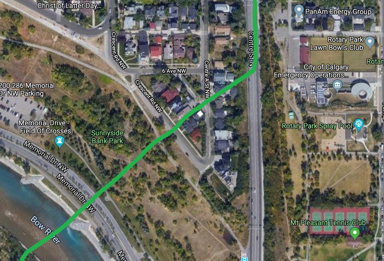

a) Interface between the bridge and Centre Street: Based on the diagram, I assume that the LRT will be running in the western two lanes of Centre Street and turn onto the bridge roughly where the bus stop currently sits just north of 2nd AVE NE). Presumably the BRT is also driving along the LRT tracks in the western lanes, and the turnoff could be designed so that the BRT could keep going straight along Centre Street, perhaps with the northbound lane eventually crossing over to the easternmost lane at a lighted intersection (e.g. 2nd Ave NE).
b) 16 Ave station: Will the platforms be on the outside, connected to the sidewalk? Or will there be an island in the middle of Centre street? If having the LRT cross 16 Ave is going to be a gong show, would it make sense to do an underground station, which would also allow the BRT to run under 16 AVE?

I saw the alignment for the route yesterday that is not that, in fact it goes through the houses just to the west of the Shaw house. Attaching a crappy MSPaint to show what I saw.
Are they going to expropriate the land? I really have to wonder about some of the decisions being made about the northern alignment. I guess this is what you get when the new provincial government reneges on promised funds and threatens to eliminate the project altogether.
I saw that image circulating around Twitter. I wasn't sure whether it was the actual alignment of the new plan, or the alignment for the tunnel in the older plan. Just looking at the elevations, that alignment doesn't make sense to me at all for a surface route. If you turned off Centre street at that point, you'd run straight into the side of a cliff. And then, of course, you have the whole issue of expropriation.
If that is the actual alignment being proposed, then it's more evidence that this plan is designed to produce a compromise where Phase 1 of the Greenline ends at Eau Claire, and the northern suburbs get a "temporary" BRT to keep them happy. And Crescent Heights accepts BRT lanes along Centre Street in exchange for the promise that Phase 2 of the Greenline will be underground and have a station at 9 Ave.
I saw the alignment for the route yesterday that is not that, in fact it goes through the houses just to the west of the Shaw house. Attaching a crappy MSPaint to show what I saw.View attachment 228338
Actually, looking at these images more closely, I think the alignment you are referring to is the original tunnel alignment. The new bridge alignment does seem to go further south on Centre and turn off around 2 Ave NE.
This is being reported as the new proposed downtown alignment
