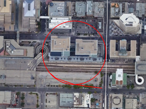

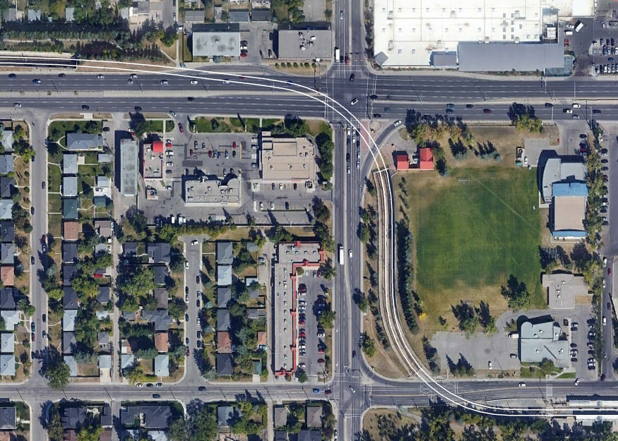

If the geometry works, a surface station in Eau Claire has the potential to save something like $100 million bucks alone, savings that can be plowed into the awful geology between 9th and 6th. I'd like it to be exclusive ROW from there to east of Macleod Trail. This is a 86 M curve, below mainline recommendation, but whatever way above the absolute minimum of 35m, and about the same as the S curve cross 16th Ave in the NW. It would allow 155m for elevation gain between the end of the tracks and 1st Street SW, which at 6% grade is enough for 9.3 m of top of rail elevation changes. Rail height of 5 m below ground (more than the absolute minimum to cross under the tracks) to 4.3 m above. 1st Street SW only has a clearance of 3.8m under the tracks, so still have 50 cm for structure and rail to play with under the top of rail.
215790
215791
This would be my preference for a 'cheap' option. Replace one underground station with at grade (Eau Claire), and one with elevated.
View attachment 215790 View attachment 215791

Oh, I think you misunderstand and I wasn't the most clear. South the CPR the track and stations would be elevated. Eau Claire at grade.
