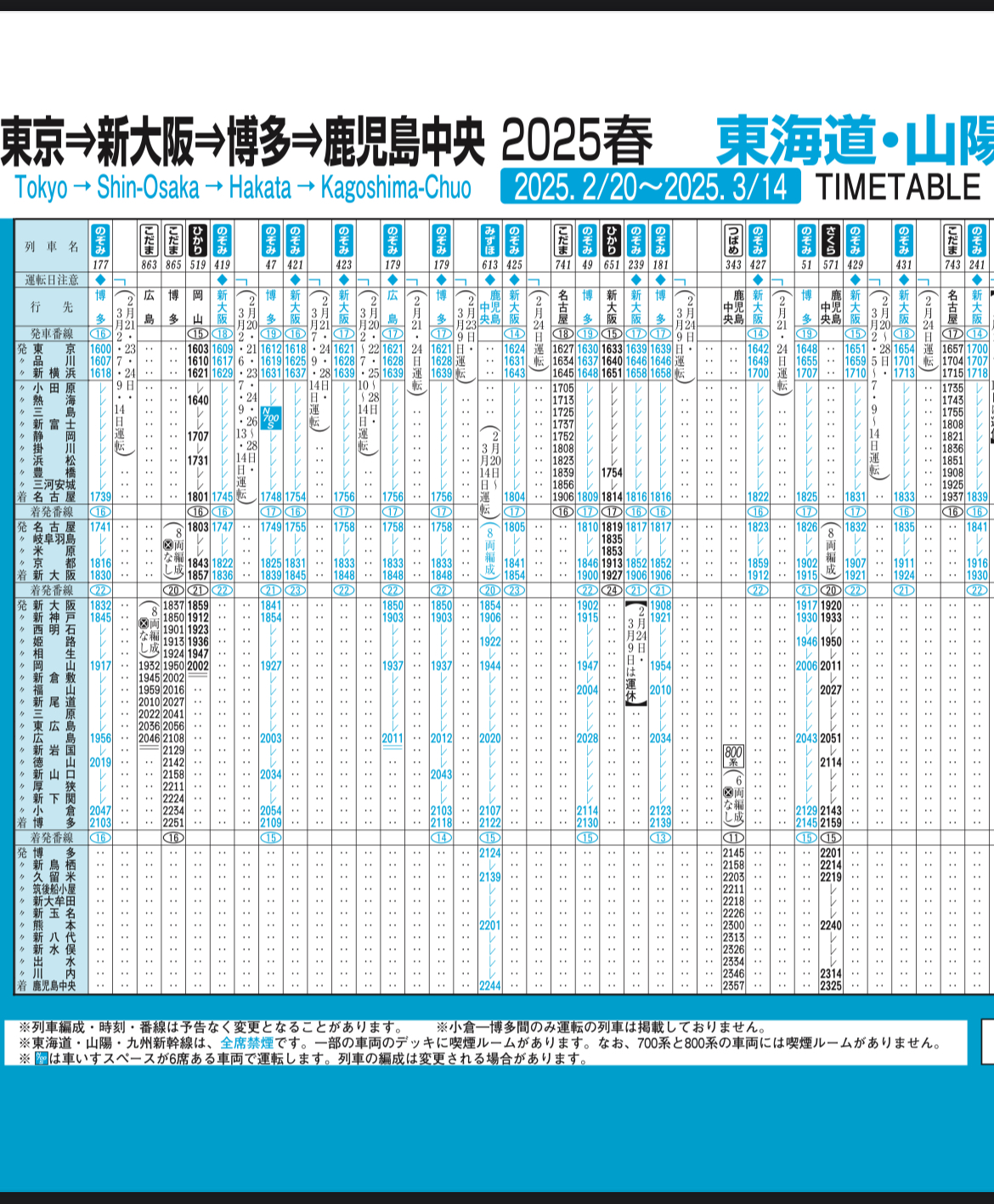

Exactly! Just because you build a station doesn’t mean that every train (or any significant number of them) has to stop there. Look at what small fraction of trains which actually stop at all these rural stations like “Meuse TGV”, “Limburg Süd” or “Maibara” rather than racing through them at 300 km/h…
It’s something like 10% for some of the small stops at the Tokkaido Shinkansen:
It’s something like 10% for some of the small stops at the Tokkaido Shinkansen ...
