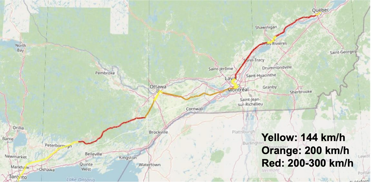

Good news, as I've hinted previously, only ~200 km out of the 600 km section from Toronto to Montreal needs to be at 300 km/h design speeds. Similar case for the full ~1000 km.
Most of Alto will likely be built to 200 km/h standards or lower. The target travel times imply <200 km/h average speeds while having only 7-8 stops. For Toronto-Montreal the average speed is about 191 km/h. Alto has lower stop density than the typical 300 km/h Spanish or Chinese line.
Total route distance: 596.618 km → >200 km/h distance share: 183.237 / 596.618 = 30.7%
Total moving time (excluding 2+2 min dwells): 187.002 − 4.000 = 183.002 min → >200 time share: 37.562 / 183.002 = 20.5%

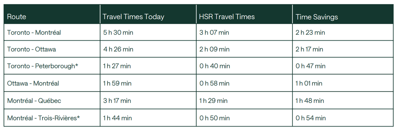

187 minutes is 3 h 07 min, same as Alto’s target travel times. Based on that and this map from the November 2022 Alstom Via HFR presentation (slight modifications), I made a table:
Step (west→east)What’s happeningCap / targetDistance (km)Time (min)Cumulative dist. (km)Cumulative time (min)
