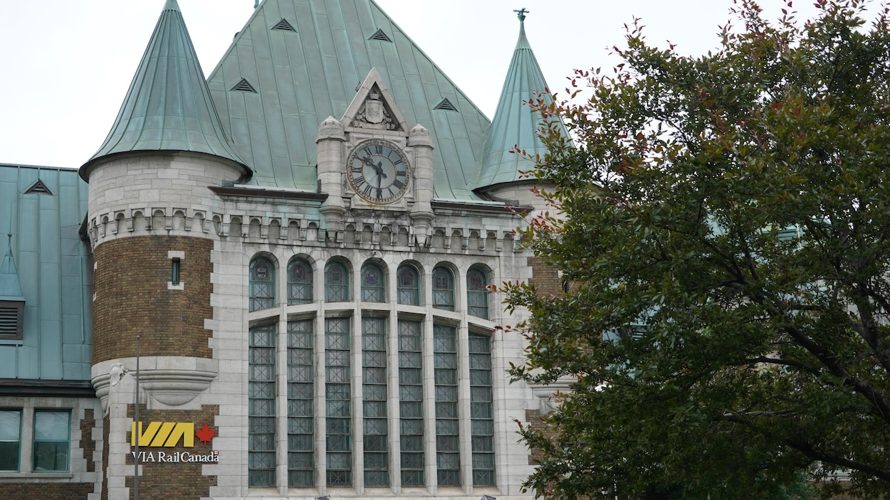

Quebec City's station will not be downtown, and might be near the airport (at the western end of the tramway), but the train itself won't go to the airport.
Does the tramway itself go to the airport?
I'm not familiar enough with quebec city to know if this is a big deal tbh.
