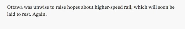

Opinion | In the face of Trump’s attacks on Canada, is high-speed rail the nation-builder we need — or just a waste of money?
Ottawa was unwise to raise hopes about higher-speed rail, which will soon be laid to rest. Again.
https://www.thestar.com/business/op...cle_f1fff162-f2e4-11ef-b1d2-bb643fc0f5e4.html
The entire pundit-class in Canada seems to be in complete agreement that this project will never see shovels on the ground. Cynicism abounds.
I'm hoping they finally get proved wrong.

Hopefully the project designers don't get bullied by Quebec politicians into changing scope of project to satisfy every local politician. We don't need CAHSR 2.0
