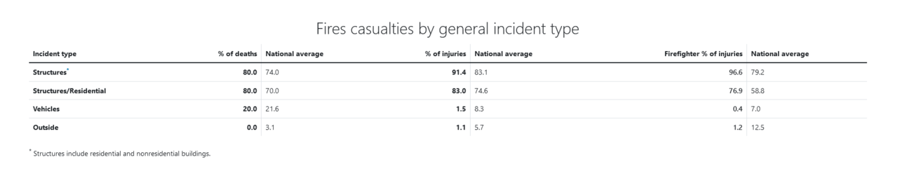

But, since you suggested people aren't dying en masse, I thought I'd look up NYC Fire deaths vs the national average for the U.S.
NYC - 102 fire deaths in 'fiscal 2023'
In 2023 - Toronto Fire reported 14 fire fatalities - all types
Source: https://www.toronto.ca/wp-content/u...June5-AODA-4-PAC1-2-Dot-op-Rot-FPspread-3.pdf
NYC has 2.3x the population of Toronto, so Toronto, so NYC's Fire Fatality rate is just over 3x the Toronto rate.
That certainly seems like a concerning difference. It may not be entirely due to housing type..........but
On its face the differences result (if scaled to Toronto) in a difference of 280 deaths over a 10-year period.

I'm happy enough to have a polite, informed, exchange, even one in which agreement is not possible.
But, since you suggested people are dying en masse, I thought I'd look up NYC Fire deaths vs the national average for the U.S.
Interesting. As you pointed out, the difference in the numbers between New York and Toronto are hard to pin on any one factor. My first impulse was to look at the fire fatality numbers from other cities/regions with similar residential densities to New York, but I'm having trouble finding useful data. Some info I was able to find: Montreal had 12 fire-related deaths in 2022, which puts it at a slightly higher rate than Toronto (around ~7 deaths per million vs Toronto's ~5; the number I'm seeing for New York is 12 deaths per million). London had 108 in 2017-2018, although that includes the Grenfell Tower Fire - 2016-2017 had 38 deaths, 2015-2016 had 21, 2014-2015 had 23, etc. - and I'm not sure which population numbers to use there. But given a population of ~8.9 million people, 38 deaths gives just over 4 deaths per million; 23 deaths gives just over 2.5. It looks like New York might be a significant outlier here, although I'll have to keep digging for more data...
There are good state-level numbers from the U.S., but those obviously aren't the same as 'City Numbers', particularly if there is more than one large urban centre.
That said, I found this media story that suggests fire fatalities in Philadelphia exceeded 40 in 2022:
That's in a City of ~1.6M
I tried for Chicago and Boston but couldn't easily find good data.
