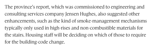

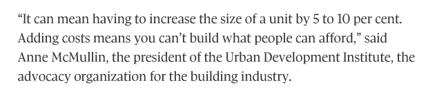

It raises many important questions on issues of accessibility, fire/smoke risk and whether the change actually provides any cost savings at all, when the offsetting regulations are considered:
(from the article)

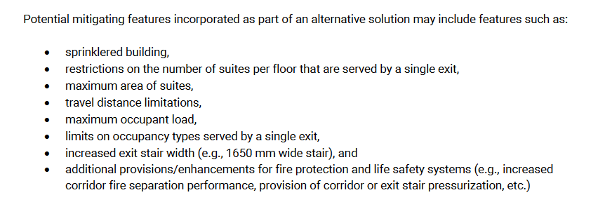

On the cost question:
The above is important, as its the only way I would consider supporting the change..........but depending on what you impose, a developer may not be any better off building than they are with two staircases.

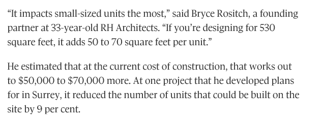

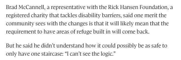

Ha, at the same time BC is discussing moving ahead with Single Egress stairs, they are doing to require that all new housing units be accessible to the disabled. This will add more than $50,000 to typical unit construction costs and obliterate any savings from single-egress and then some.
To be clear, I'm not in full support or opposition to the change, nor cheering more expensive housing......... I am, however, amused at people who were rah-rah about BC leading the way, including many developers who are suddenly jeering and the disability advocates who opposed single-egress are now cheering.

Of course, I will now add, it really doesn't make much sense to require a unit to be accessible that can't be reached by an elevator............should that mandate change.........
Both sides here, as with those advocating single-egress and more tend toward simple arguments, extreme positions and ignore risks/consequences while cheerleading their preferred pet cause.

I find the 7% figure exceedingly unlikely because offsetting conditions will be imposed. The question is which ones and how much of the savings they eat up.

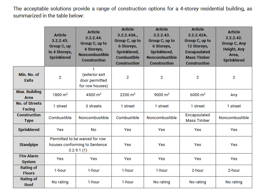

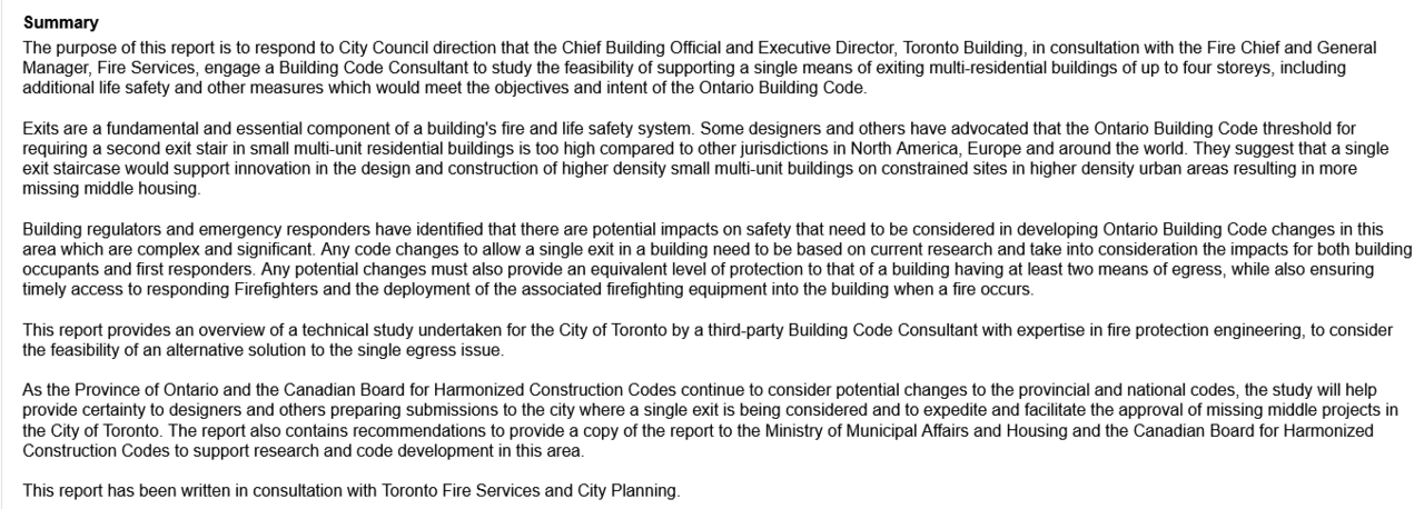

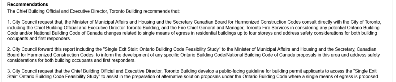

The single egress issue is the subject of a report to next week's Planning and Housing Ctte, I will post the high level link so everyone can access the staff report and a third party conducted feasibility study:
I'll post from the high level intro here:
The recommendations are as follows:
Now I will take info directly from the Study:
Good Report - Direct link here: https://www.toronto.ca/legdocs/mmis/2024/ph/bgrd/backgroundfile-247234.pdf
Only 30'ish pages.......give it a go.

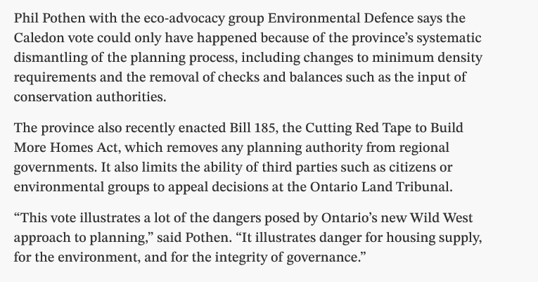

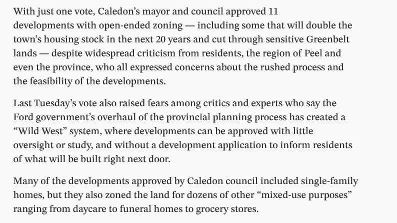

Caledon's mayor has used all the Planning/Zoning reforms to push through 2,000 acres of new sprawl on ecologically sensitive and agricultural lands; and there's no recourse to the OLT.
This @HousingNowTO is the problem with subverting democracy for a good cause........once you break the rules and wipe out the checks and balances....everyone gets to play that way.
From the above:
According to the town’s reports, the 11 parcels rezoned from agriculture to mixed-density residential would have “holding symbols” placed on the land so development could not proceed “until the listed conditions have been satisfied.” The holding symbol “allows development planning to progress but must be cleared before the zoning bylaws are in force,” according to the report.
Groves said council did not approve developments with this vote, but enacted “conditional zoning” that would allow development to continue through the planning process.
Coun. Sheen says that despite the contentious decision by council, it’s not “like the sky is going to fall. We will still have to bargain, negotiate and hammer out what these communities will look like.” The only immediate effect, he said, is that the “lands went from being zoned agriculture to residential and so these land values went up, probably quite a bit.”
Some other quotes about it being conditional zoning.
