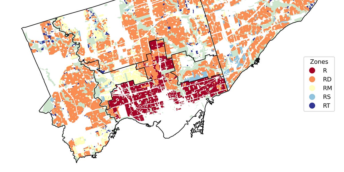

Here's my take on Damien's piece.
1) I think overall he's too harsh on EHON and understates the degree of change.
2) I think he has very valid points on FSI and even more so on lot coverage minimums. (I agree with removing the former on smaller proposals in neighbourhoods and the latter entirely)
3) He focuses a bit on the Bridle Path as the clear worst offender in terms of exclusionary zoning and he's entirely right on that. I have literally advocated in these pages for buying up the Bridle Path, and leveling anything that is designated heritage, and starting over. Even if it were left as an SFH subdivision, it could easily go from ~60 houses to ~360 houses and still be large homes on large lots. That said, It would make immense sense to be to do midrise on portions of Lawrence, and Bayview and potentially Post Road *
* I would really like to carefully consider the options for connecting Lawrence to Lawrence directly. It would be challenging (lots of big bridges) and could potentially adversely impact either York U's Glendon campus or Toronto French School's........still its worth a closer look.
If one did midrise at the edges of the Bridle Path, and some streets with luxury towns and or more conventional SFH etc. One could easily have triple 900 housing units which would be 15x the current number. That wouldn't make a dent in the City's housing crisis, but it would be a tangible gain and one that would make for great optics/symbolism.
5) I want to ask UT's zoning guru....... @innsertnamehere how a multiplex can be legal under EHON but a semi-detached is not. That seems silly, and contradictory.

simple - multiplex is permitted, but semi-detached is not.
One example of how it can work in a more convoluted way - Hamilton recently passed similar legislation to Toronto opening up development in residential neighbourhoods.
The rules for one of the zoning categories are:
Minimum lot frontage:
Single-detached: 15m
Semi-detached: 7.5m
Townhouse: 5m
Result: you can build 1 detached, two semi-detached, or three townhouse units.
Want to build a 7.5m single-detached though? NOPE. It's stupid. The built form is basically the same, and a 7.5m single-detached is basically the Toronto special at this point down the QEW and results in the same density at a higher resale value that a 7.5m semi-detached would go for.. but not allowed! And good luck arguing a variance for it as it's "halving" the minimum lot frontage for the use, so I hope your end buyers like sharing walls!
Another issue I've seen with Toronto's multiplex by-law is that it does not override any existing site-specific regulations. So if there is a neighbourhood-specific standard regarding FSI or height or building depth or whatever, it continues to stand despite the base restrictions on those things being modified or removed. So while Toronto "legalized" multiplexes city-wide, the reality is that much of the City continues to have strict restrictions on these.
Ultimately most municipal zoning is way too prescriptive in general and needs vast simplification to enable intensification. Focus on simple performance standards like height and minimum setbacks from adjacent properties, and forget about differentiating how the buildings are divided on the interiors. Oh, and get rid of the old site-specific exceptions enforcing the old rules.
Toronto generally has by far and away the most complex zoning by-law in the province by several orders of magnitude. The City really needs to get a "zoning simplification team" put together to start pulling the by-law apart and simplifying it.
