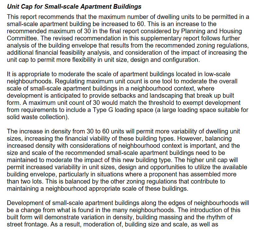

The Supplementary Report from the City Planner is now available for EHON major streets.
They have revised the Unit Cap to 60 units.
Report Link:

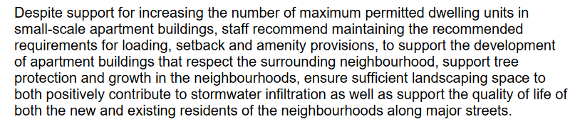

From the above:
Staff are retaining the amenity requirement, I disagree and would love to hear a member of Council challenge them on what this amenity space would be in a small building and what value it would produce.

So would 60 units and relaxed angular plane requirements make for significant improvements over current yellowbelt development pro-formas?
It certainly improves the viability of smaller scale, main street development.
However, its worth saying, the City's own analysis showed that under the 30 unit proposal, you couldn't actually build a rental building in Scarborough workably, at least with any consistency.
As structured, I don't expect it to generate hundreds of proposals in the first year.
Part of that is just the market being in the toilet right now; but part is also some of the remaining complexities and challenges.
If all goes well, I imagine you may see a couple of dozen sites move forward in the first 18 months. But in the current market, those may be at the expense of other proposals getting stale.

I'd ditch amenity requirements first.
They are dead space from a selling/renting point of view, and in small developments that's financially significant. The added bonus is that it doesn't make anything 'worse' from a neighbour's point of view.
I think the setbacks need work, but the problem there is that I don't think the solutions are uniform; that is to say, I don't think the setback rules should be the same on every street, every corner and every lot, and trying to make a worthwhile change,
at the City-wide level is more challenging.

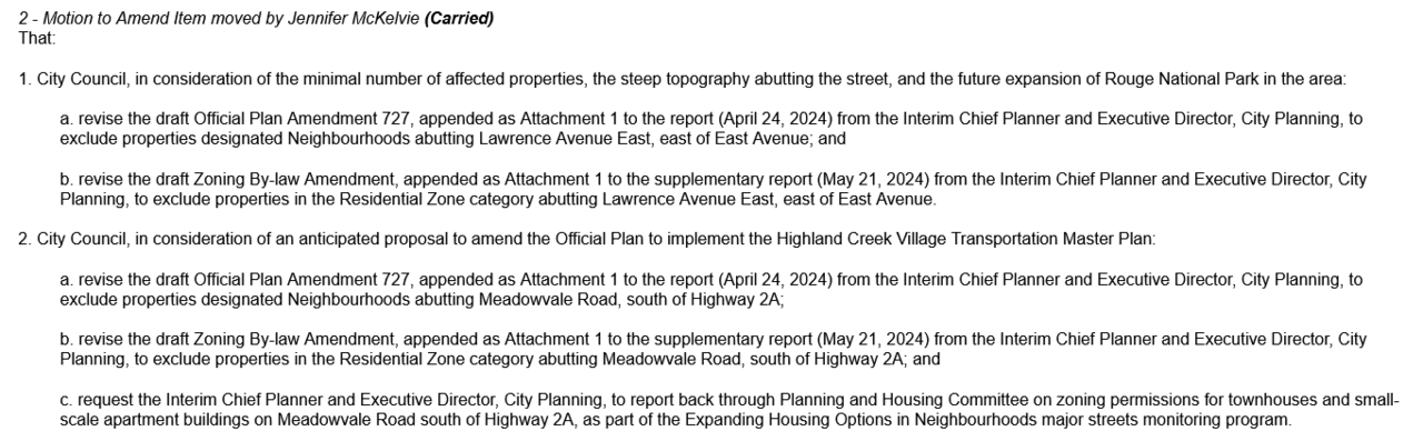

But Councillor McKelvie did get an exclusion........one of which definitely seems meritorious, the other I need to look into.
Interesting tidbit there.............expansion of Rouge Park coming...

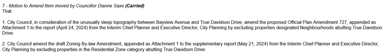

Also Councillor Saxe got this:
This one makes perfect sense as the houses in question are way above Bayview avenue at the top of forested slopes.
