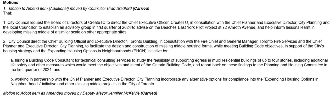

The Amroth Missing Middle Report was adopted (at Committee) with (friendly) amendments from Cllr. Bradford:

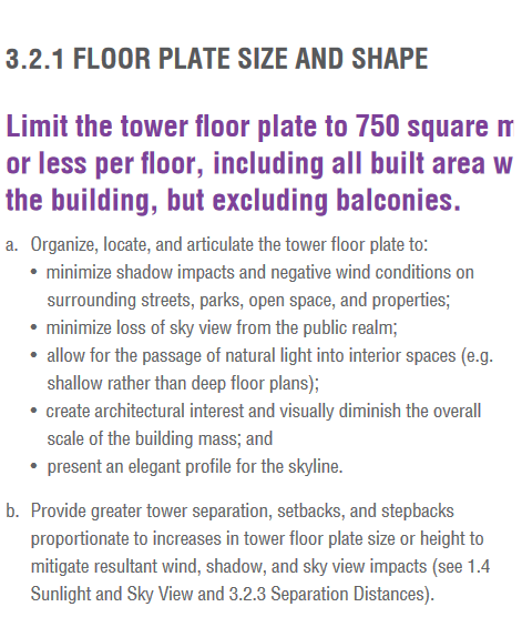

Not sure if this is the best thread for this question, but here goes.
What is the logic for max floor plate size for residential towers (750 m2 in area)? I understand the shadow impacts of larger floorplates, but we allow commercial office towers to have larger floorplates. It seems to me that relaxing the max floorplate rules somewhat could go some way to allowing the 10 or so units per floor to be a bit larger, more livable, and perhaps more affordable (on a per sqft basis).

The detailed rationale is on p.50 of the document to which you are linking.
It is first/foremost about shadows and skyview; but there are other reasons given:
The floor plate size, one should remember is not so limiting on podiums or midrise forms; but for towers/tall buildings.
What they are specifically seeking to avoid was the proverbial commie-block, or rectangular-slab tower that many of Toronto's 60's and 70s apartment buildings are built like.
Those tend to create extended periods of shadow, (hours on end if positioned with their width against the southern sun). That disavowed layout did have its advantages though.
The guide lines do note room for exceptions, and there are exceptions that have been made (more lately). If you can address those shadow concerns in a few different ways, there's less reason not to do a larger floor plate.
Above you see stepbacks and separation distances mentioned. But there are other things one can do or situations one can encounter that justify reconsideration.
For instance, what is being shadowed? Homes/apartments/parks not so good; but factories/railways corridors/highways, maybe not bad at all, maybe even beneficial in many ways.
Also, orientation matters, if the long rectilinear form runs north-south (so its a slim profile in relation to the primary direction from which sunlight is received, it is and should be considered, less of an issue.
Blocking all eastern/western light is less consequential than blocking all southern light.
There are other arguments for a more compact floor plate; there is 'elegance' (made above). i wouldn't get stuck on that one, but we do know how people here feel about Time and Space as a sort of fortress that doesn't play nice w/the neighbours, again that's the sorta thing they wanted to avoid.
There are arguments around energy efficiency, though they more impacted by cladding/glazing and a host of other things really.
I think the guideline has never been as absolute as people have made it out to be; its just that there's always been an onus on the proponent to show why they should have a larger floor plate, and most don't see it as that useful to them to have the argument.
At the same time, due to OLT, planning is a bit obsessive about precedent, it wants compelling reasons for allowing exceptions; I do think that's understandable, if a bit rigid.
That said, the interpretation of the guideline is being loosened a bit.

What they specifically seeking to avoid was the proverbial commie-block, or rectangular-slab tower that many of Toronto's 60's and 70s apartment buildings are built like.
I agree that 'commie blocks' are not appealing. I was thinking more a modest relaxation of the 750 m floorplate. It seems like policies looking for larger family sized units are somewhat at odds with this floorplate guideline. Given a typical 10 units per floor on a centrally loaded tower, after taking out space for the core and hallways there is perhaps 600m2/6000 sqft for 10 units, or an average of 600 sqft. Allow the floorplate to expand a bit while keeping the core and central access hallways and number of units constant, it would provide for a significant increase in average unit size, as well as more exterior wall per unit. Going from 750m2 floorplate to 1000m2, perhaps while capping units per floor, would enable average unit sizes to increase from 600 ft2 to 850 ft2, 31% more space and ~16% more exterior wall per unit. I agree that it would be desirable to keep floorplates from getting too large lest we get more bowling alley unit layouts. I suspect this might be playing a role in the skimping on elevator ratios in some proposals as well, as each shaft in the core takes away from sellable sqft.
