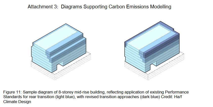

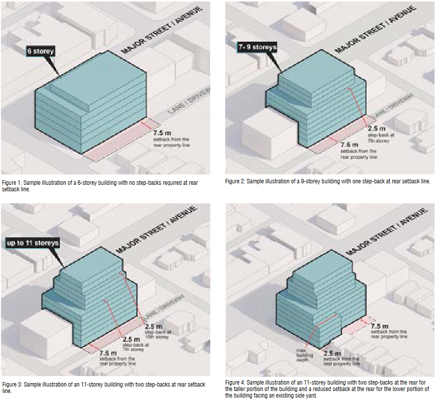

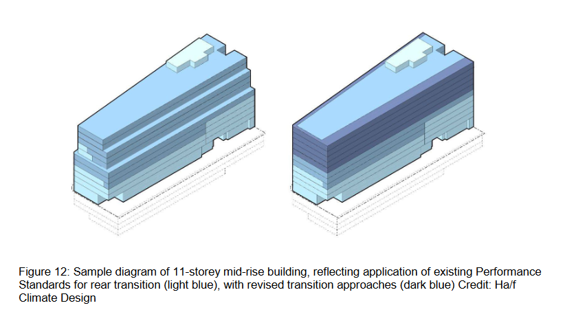

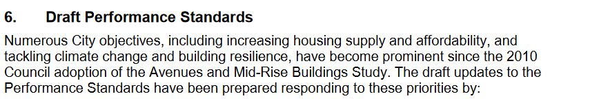

@ADRM , @allengeorge, @innsertnamehere, @ProjectEnd and @HousingNowTO will likely take particular interest in the report to the next Planning and Housing Ctte linked below.
Its the new more flexible standard (draft) for angular plane on midrise sites.
Report:
Standards:

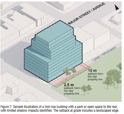

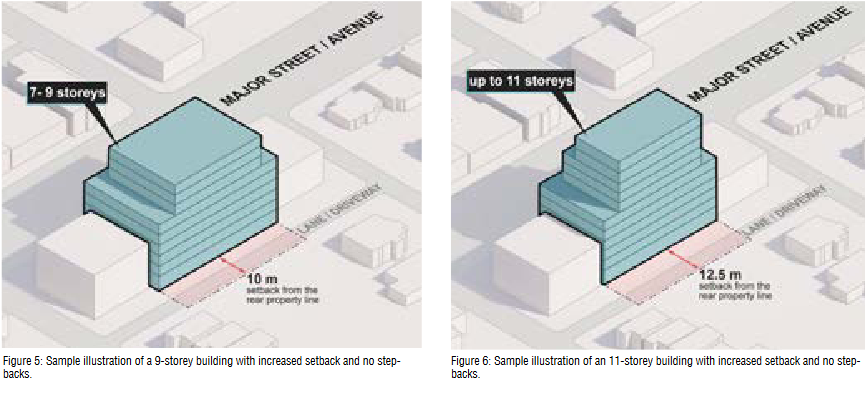

These are examples of what may be permissible in the new standards (as you can imagine there are details and caveats)

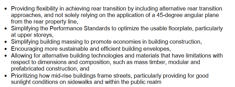

From the report:
There's far too much text to just copy/paste everything so I'll put this bit, and then say, follow the links for the rest:
wow... What a turnaround from staff in just such an insane number of ways.
Staff have long contended that "market feasibility / building costs have no bearing on planning" as if city planning is completely disconnected from financials somehow. Even just the report acknowledging that removing angular planes will reduce building costs is a huge step forward on that front.
This paragraph is also pretty notable:
There may be opportunities where an increased building setback from the rear property line and provision of fewer or no step-backs is appropriate. This option should be considered on a site-by-site basis and informed by pedestrian level wind testing (Figures 5 & 6)
This represents a significant step away from staff treating the guidelines as a hard policy document which must be met no matter what, and moves closer to acknowledging that they are *guidelines* and that in some cases a different design could work.
In general this is a huge step forward and is generally much closer to what I would consider to be reasonable transition policies.
This one "small" change should instantly improve the feasibility of most avenues sites for development drastically. I expect to see a lot more midrise applications moving forward, especially now with parking regulations gone.. I could see a lot of 8-10 storey midrise applications with stacker parkng accessed off the rear lane and no underground.
Honestly I would probably take it a bit further and just require a single 2.5m step back above the 6th storey and be done with it.. but that's me.
