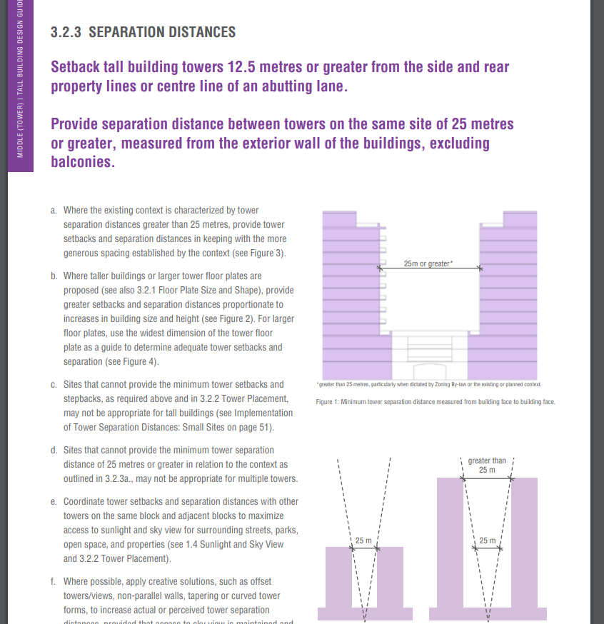

The City has changed the way its interpreting the separation distance guideline.
They used to measure from the face of the building to the face of the building to define 25M apart.
Apparently they are now measuring from the outermost part of the balcony to the balcony of the next building over. That essentially makes
the separation distance in the range of 29M if both buildings have balconies.

Ooo I hope that isn't the case. Some of the plots of land I work with are difficult enough going face to face, though I know tricks will be done with balconies to avoid some of this. ie. inset or a gap in the area of question if on an angle opposed to parallel buildings.

The city already has a by-law prohibiting inset balconies on the tower-portions of buildings, only permitting them on the podium. (technically it's a by-law mandating 25m separation of main walls, but an inset balcony creates a condition where two main walls face each other on either side of the balcony, violating the by-law requirement). You could probably put inset balconies on towers through your by-law amendment, but you would get push back from urban design as it would "increase the visual scale of the tower floorplate" or something.
As for removing balconies from tower separation distances, It's definitely something the city is asking for, though not consistently. I don't believe they have any hard policy prohibiting it, or even a guideline, so there is room for developers to push back.
Another one is they have started asking for tower set backs from the podium to include balconies as well, which is fun as it effectively forces your tower step back to be 4.5m instead of 3m. Again, no hard policy on it though, so you can push back.

"Death of balconies" would be a happy unintended consequence IMO... I never quite understood the obsession with them as they (a) are ugly in most cases, (b) reduce usable living space in the case of inset balconies and (c) are completely useless 8-9 months of the year in a northern climate.
I believe the balconies are still not included from their tall building guidelines. Unless they haven't updated their website to a newer version than the 2013 one.
I just hadn't heard of any pushback in our office so I thought I'd relook, though there is verbiage that dictates larger separations the taller the building. Makes me think of 1200 Bay and the non existent setbacks there.
Also, we use inset balconies fairly often. The L Tower is a good example of that.

But back to the tower distances, I'm not sure how much these are enforced. The Whitfield is going to be 18 m or less from my balcony.
