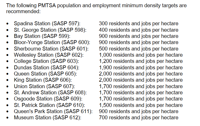

A few items from said report:

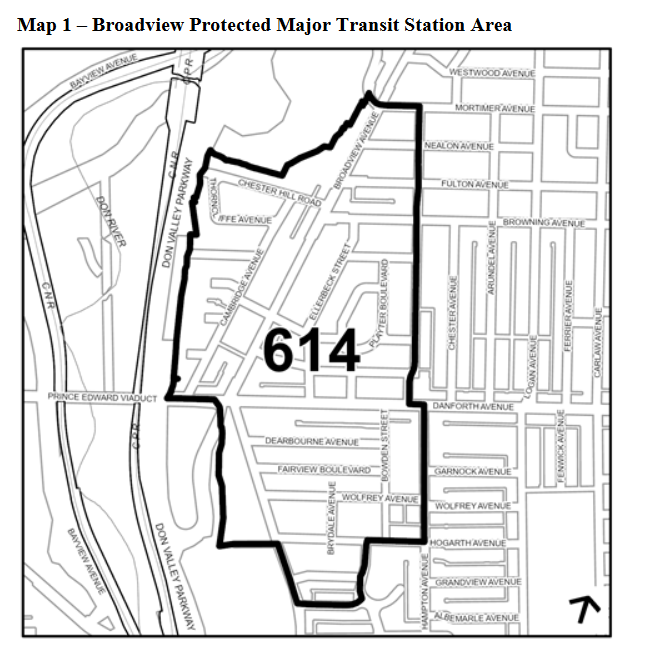

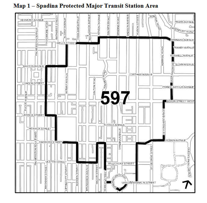

I'm not going to post the maps for each MTSA as that would require 3 posts, but I thought I'd put an example up:
All the MTSA Maps can be found here:

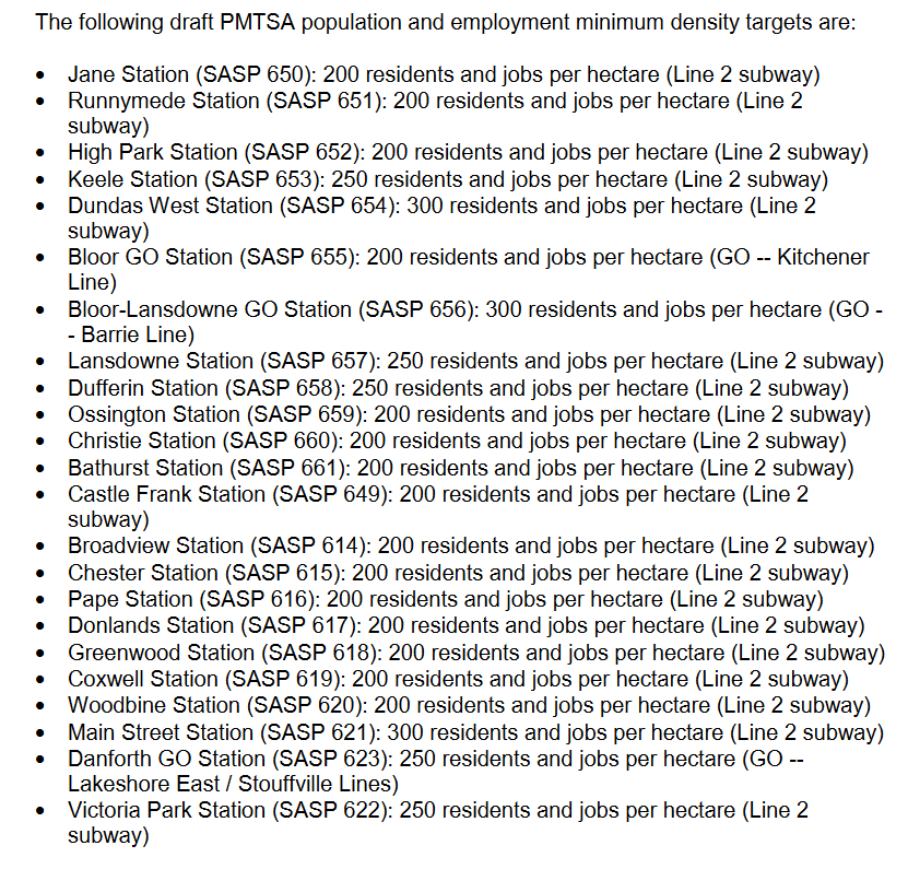

Those population+employment minimums for Line 2 are ridiculously low.
I see TO Planning still hasn’t changed that huh.
As minimums, not maximums, I'm not necessarily phased by that.

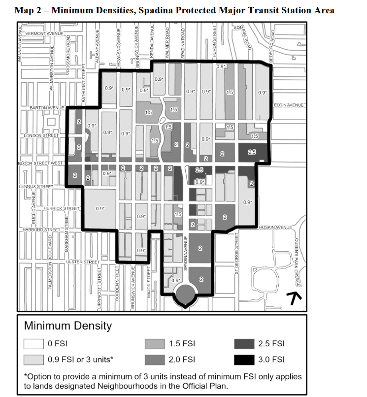

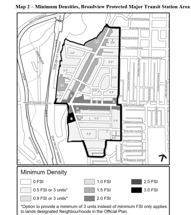

I do not have the time at the moment to go over each map, I'm sure I would find a few places where Planning and I would not agree!
What I do find unfortunate is that the report maps don't show before/after, so you have to look that up yourself!
They also don't show how close the areas are to meeting or exceeding the targets. Is there any point in the exercise if, for argument's sake
you impose a 200 resident + job density and you're already at 300 within the map area?
I suspect some streets may be lined with heritage homes and big trees and any bump in minimum density is likely only to encourage/permit multiplexing within said buildings.
That's something I'd probably be fine with in many cases, but again, I (you/everyone) would need to look street by street to see what has or has not been upzoned and what reasoning Planning provides for same.
In the end, I find the reports to be insufficiently informative to easily evaluate the proposed changes, and I object to that being added to my work program! LOL
