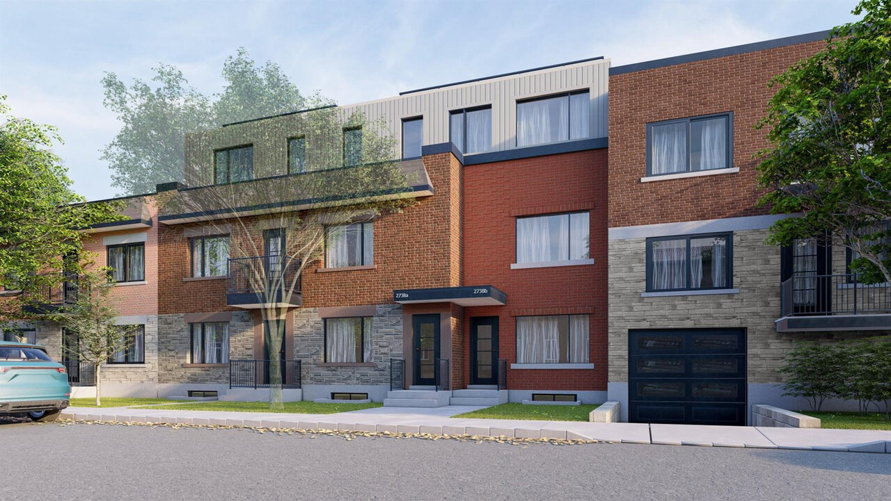

Montreal does exterior stairs, sometimes on highrises. It's also very common to see external fire escapes added to historic buildings and most new low rise buildings have steel fire escapes at the rear which double as balconies. The building I live in has a fire escape that is accessed via a large window that swings open like a door and closes with a latch
https://maps.app.goo.gl/U6dHBPxy4AjkXPjQ9
https://maps.app.goo.gl/szJyHp4GyVZCmMAp6
https://maps.app.goo.gl/WBJQGwYVnFjcr22WA
Montreal's average annual snowfall is around 209.5 cm (over 59 days). In comparison, Toronto's average annual snowfall is 121.5 cm (over 41 days).
Yet Montreal has the outdoor stairs.
Montreal does indeed feature the above.
Its certainly a trade-off in terms of accessibility. We're not just talking wheelchairs here........those cute, but tight, steep, circular stairs are tough on anyone with less than ideal mobility or who has to move bulky items up/down.....even in good weather. In rainy/snowy/icy conditions they often pose serious issues.
I don't argue we should rip all the heritage ones out.......or not show an open mind on code changes.............merely that people who are argue single means of egress generate huge savings, are generally wrong; and there is no evidence to support this......there are trade-offs and some do carry potentially serious consequences.
