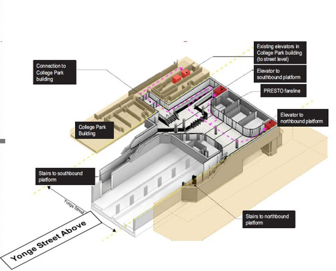

At College, the second entrance construction includes the elevator access to the platform. This will not be provided at the main (north) entrance at College/Carlton, but further south through the College Park (former Eaton’s College Street) building.
The view below shows the south end of the station under Yonge Street. Both the new sets of stairs and the elevators will lead to a new concourse that will be built under Yonge Street with a connection into the lower level of College Park. Riders will use elevators in that building to reach street level.

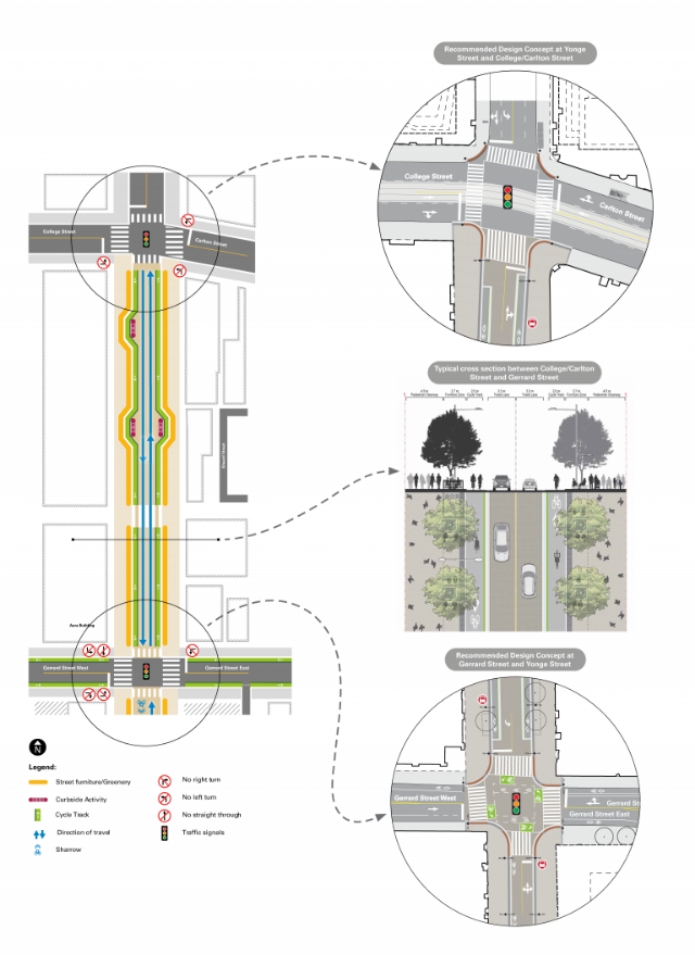

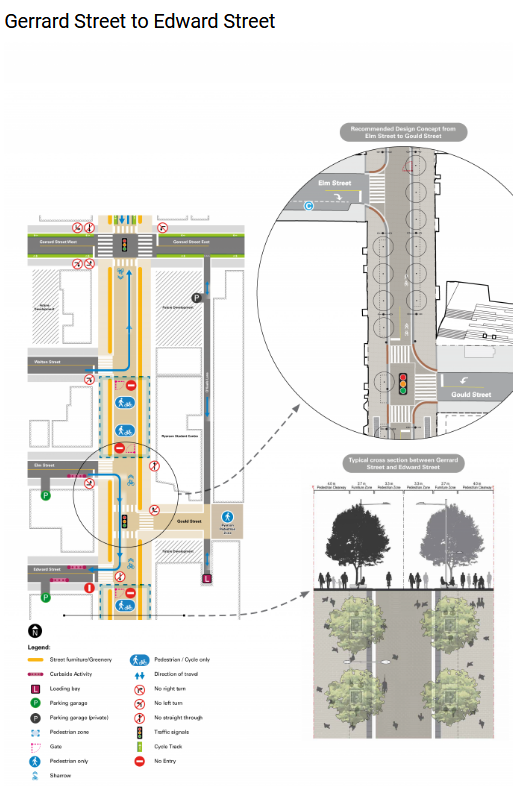

The Recommended Design Concept is 4c – Pedestrian Priority Zones with One-Way Driving Access (Gerrard Street to Walton Street & Elm Street to Edward Street) and Cycle Tracks (College Street to Gerrard Street).

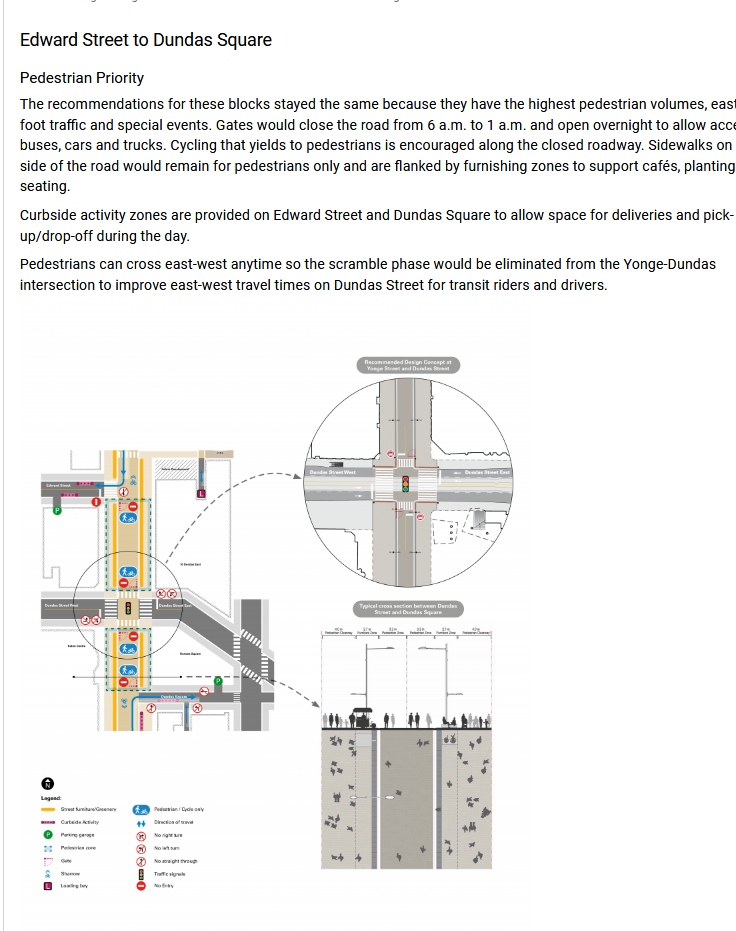

The section between Edward and Dundas Square would be pedestrian/cyclist only except after 1AM, when automatic gates would open to allow for 320 Yonge night buses (or any other situation, such as shuttle buses or emergency access). There would be limited vehicular access between Shuter and Dundas Square, between Elm and Edward, and between Walton and Gerrard.
