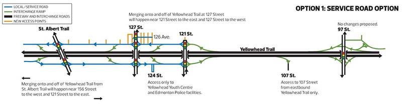

Option 1:

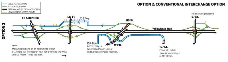

Option 2:

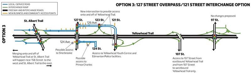

Option 3:
Option one would probably be better if they could add an EB onramp that flies over the offramp between 127 ST and 121 ST (similar to Glenmore Trail WB at 5 ST SW in Calgary). Otherwise you would have a lot of traffic merging onto EB Yellowhead at the one onramp at 121 ST. 107 ST could be connected to 121 ST in a similar fashion to Option 2 to eliminate the weaving that would have to happen for people merging and exiting at the location north of Blatchford.
Option 2 has the St.Albert Trail merge too close to the 127 ST exit.
Option 3 doesn't seem too bad in my opinion.

I vote for Option 2 except for the St. Albert Trail on/off ramp issue... Eastbound Yellowhead @ AHD on the West End is a classic example of bad design...
