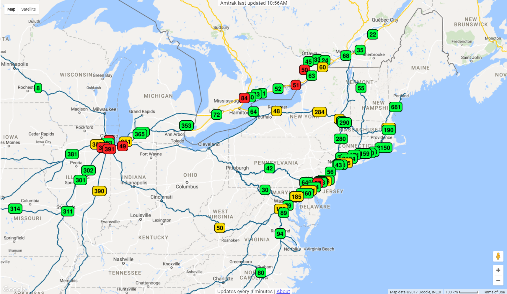

If you ever want to see which train is in service you can always see this website. It doesn't track deadheading though.
just took a quick skim through the tracker....cant believe how many trains are significantly late... Via and Amtrak ....avg is like 15-20min. only 10% of the trains are classified as on time...
Not sure what you are seeing, but this is my view:
Well its when I click on each train. most of them say its between 10-20 min late even. then again perhaps they couldve caught up and I was mainly looking at the corridor routes

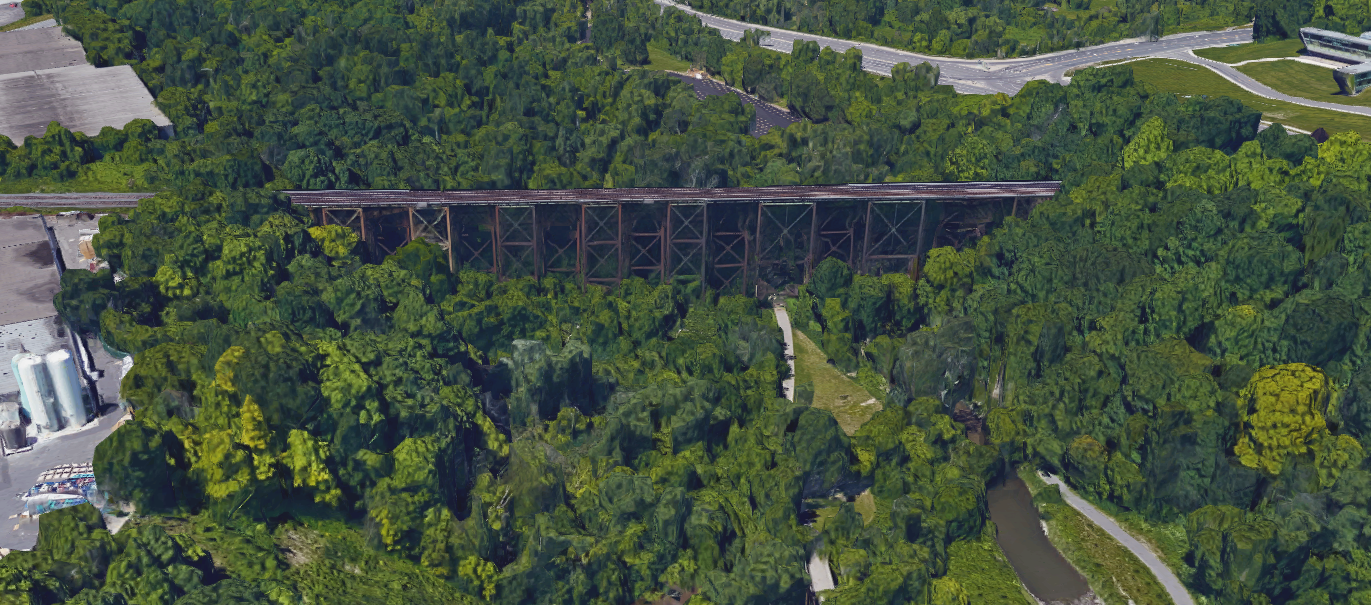

Feel like the Half Mile Bridge could be done affordably. Just a teardown, rebuild as simple concrete. What I think could be much higher cost/complexity is the active CP bridge over ET Seton. It's shorter length, but is a web of angled steel beams that I guess will be duplicated when it's twinned. But yeah I only gave a cursory glance at the VIA proposal numbers, but they seem very low for massive task. Ditto for the ambitious speeds.
