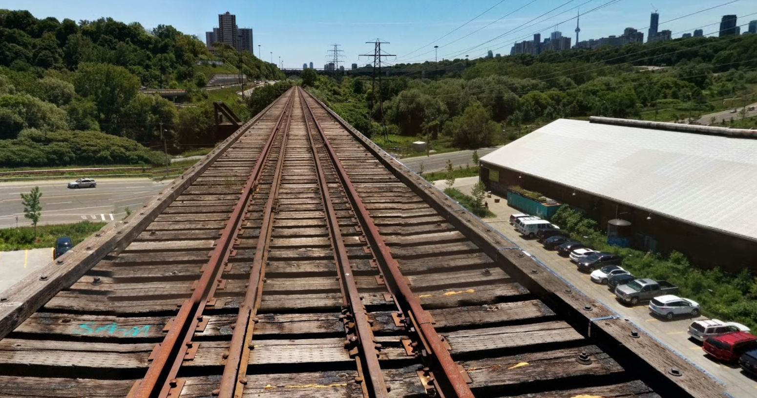

On a side note, yesterday at around 8 I saw what looks like the Ocean passing over the DVP towards union. Does this train actually have a scheduled trip to Toronto or is it just a dead head>?
Are you sure it wasn't the Canadian? It's pretty late these days (the forest fires in BC don't help) and yesterday's arrival scheduled for 9.30am was so late that the departure was rescheduled from 10pm to 2.30am...
Are you sure it wasn't the Canadian? It's pretty late these days (the forest fires BC don't help) and yesterday's arrival scheduled for 9.30am was so late that the departure was rescheduled from 10pm to 2.30am...
youre prob right on that one... the last long via train that I took was the ocean so by default it popped in my mind. but then again if it was coming from the west wouldnt it be popping in from the lakeshore West?
Canadian comes down the Don Valley on the way into Union, and out via the Barrie line.
