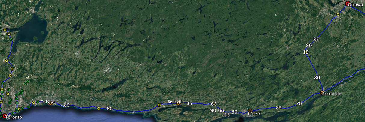

Correct me if I am wrong, but VIA ran a Mtl-Tor Service under 4 hours (3:59).
You're right. I was just looking at the current schedule. It's a shame that they can't run trains in that amount of time anymore. Freight conflicts probably prevent it, which just goes to show what would be possible if passenger trains had their own route. 3:59 works out to an average speed of around 135 km/h.
@Urban Sky do you happen to know anywhere a member of the public could find the track speeds for the Kingston Subdivision, Smiths Falls Subdivision, Alexandria Subdivision etc? I keep having to rebut this myth that VIA is slow (which is obviously disproven by schedules as per @MisterF ), but I only have the GPS data from my own VIA trips to go by, as well as an outdated speed table from GO Transit for the area around Toronto.
For example, here are the slow points from an Ottawa-Toronto trip I took a few years ago, rounded up to the nearest 5 mph. The rest of the time, the train was generally going 95mph (153 km/h), except between Fallowfield and Smiths Falls where it increased to 100 mph (160 km/h) and between Pickering and Toronto where it dropped to 90 mph (145 km/h).
15 mph = 24 km/h
55 mph = 89 km/h
65 mph = 105 km/h
70 mph = 112 km/h
75 mph = 121 km/h
80 mph = 129 km/h
85 mph = 137 km/h
90 mph = 145 km/h
