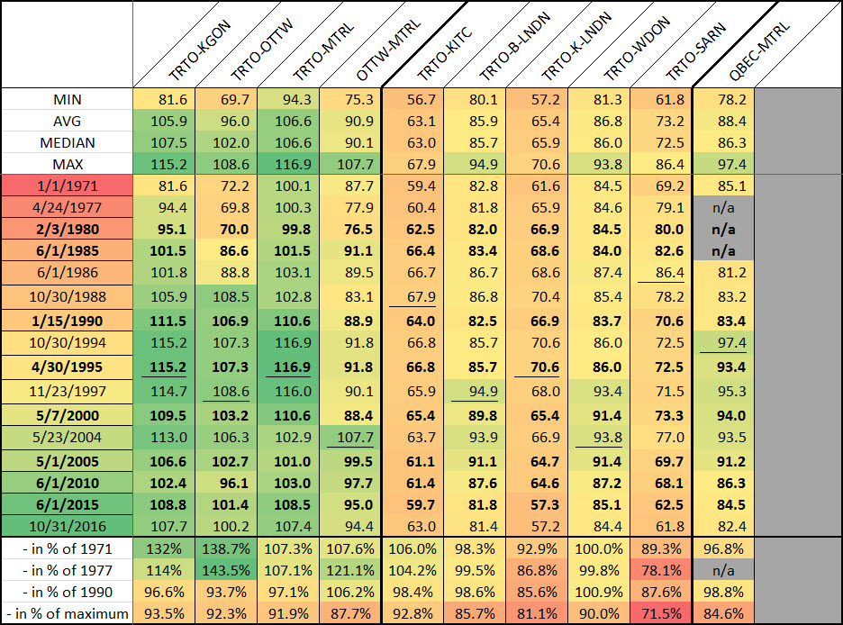

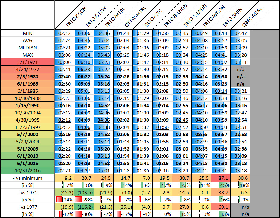

Don't ask me why I still bother debunking your romanticization of the 1970s and your tirades of unsubstantiated and largely incorrect claims. Travel times on the Southern Mainline (TRTO-LNDN-WDON) are virtually unchanged compared to the 1970s and on the Northern Mainline travel times are even five minutes shorter east of Kitchener (TRTO-KITC) than they were back then. The only routes in Southwestern Ontario where travel times have increased significantly since the 1970s are TRTO-KITC-LNDN and TRTO-SARN (i.e. those relations which are slowed down by the poor track conditions between Kitchener and London and/or the rerouting of TRTO-SARN trains via the Northern rather than the faster and shorter Southern Mainline). Curiously, travel times between Toronto and Ottawa were almost two hours longer than today and the number of trains offered per weekday were 3 rather than today's 9:
Average scheduled travel times on the main routes in the Quebec-Windsor Corridor:
Compiled with data obtained from: Official VIA schedules
Concerning average scheduled train speeds, these are already close to what you can reach by car without violating applicable speed limits for the Southern Mainline and above that on the Toronto-Ottawa-Montreal triangle:
Average scheduled travel speeds on the main routes in the Quebec-Windsor Corridor:
If you are looking for the "golden" times where passenger trains were so much faster than today, you should be looking at 1986-2004 rather than the 1970s.

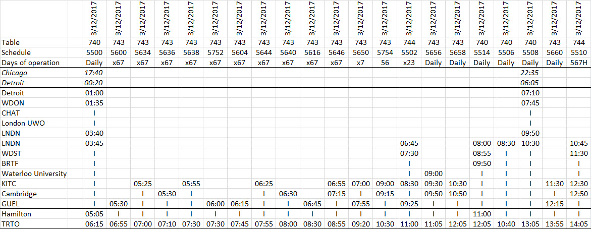

People in London already need a reduction in VIA times by 20% just to make it competitive with the Greyhound.
Have a look at the Greyhound schedule below and then tell me how competitive it is for commuters traveling from London to Toronto in the morning:
Compiled with data obtained from: Greyhound Extranet
