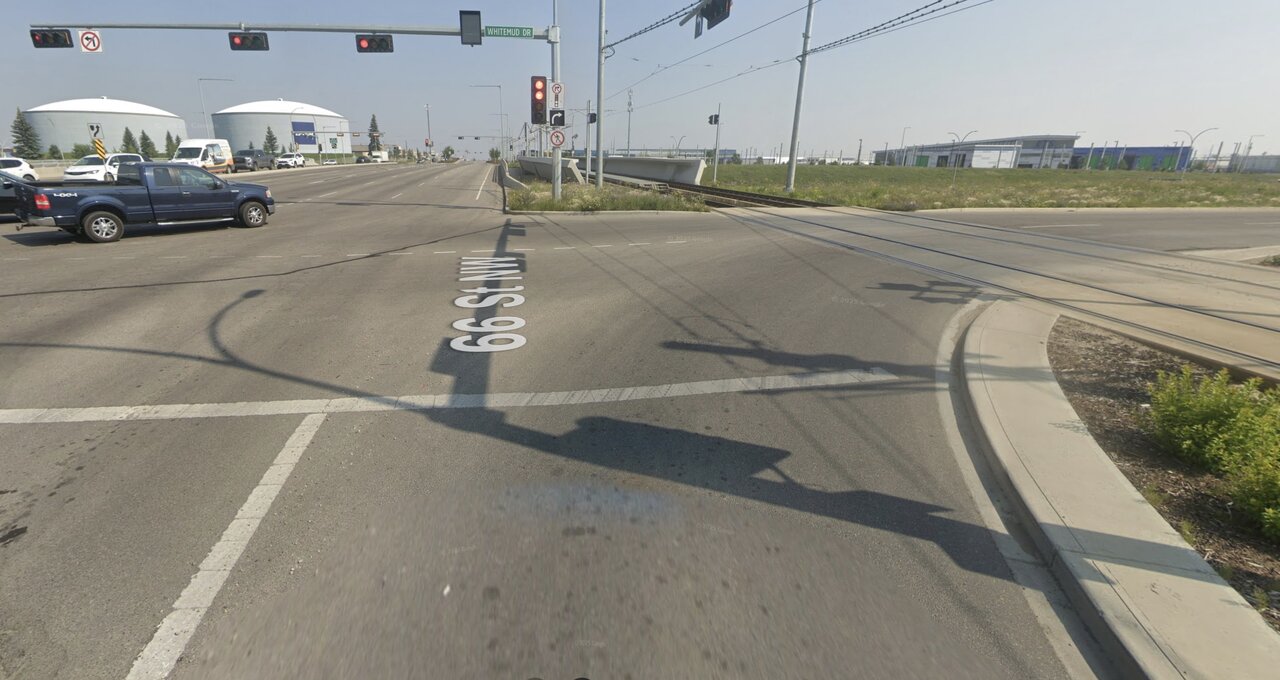

To my untrained eye, I think there's also an engineering issue here. Yes, the driver is definitely at fault, but the road design isn't helping them get it right.
Here's the intersection:
https://maps.app.goo.gl/oSEigF5FpQneMFmU6
By the time a right turning driver gets to the stop line (providing they respect it), their tires are already pointing to the right. That may put them in the mindset of a regular intersection, watching for traffic coming from the left, but not looking at the light or watching for traffic on the right. I've often come across a similar reality in bike lanes.
My recommendation would be to move the stop line back, maybe 3 metres from the intersection; Install a 2nd right turn light on the near side; Force people to sit back and have their wheels straight as they face the traffic light.
You can't fix stupidity, but you can try to mitigate its worst effects.

I like you recommendation. I know there's signs and lights but that intersection's design is a disaster waiting to happen and it did. Not very substantial for a passenger train potentially crossing.
I see more of a caution/warning signs for steep grades on mountain roads than I do in that intersection. The flashing yellow lights , multiple slow down signs and sometimes grooves in the pavement to force you to slow down. Now that's when you know it's serious.
crossing gates would be nice. Regardless of the negligence that might lead to these issues, gates with lights and bells could save a lot of train downtime, repair replacement, and potentially injury or death. The incidents happen often enough would be interesting to see the cost/benefit analysis.
