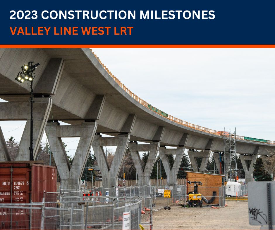

Its very interesting to see Marigold NOT need to fill in the open Y pillars like TransEd said was necessary.
It wasn't the issue or Y pillars not being possible it was the due to the shape and structural support within the concrete for the versions TransEd built as I understand it.
Also the OC spacing seems to be tighter, meaning less load per column.
The design specs arent any different but I am NOT some sort of city double agent with access to all the secret answers,
Well you see, these were designed correctly 🤣
IIRC TransEd said in their fuckup explainer video that the lack of sufficient rebar and design of the Y to have all three points along one line meant that lateral forces from the trains would crack them. Presumably Marigold put enough rebar in these pillars, as well as the crevice of the Y being higher than the sides so essentially they're already "filled in" like the repaired piers
