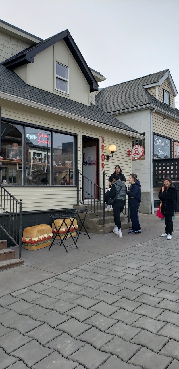

Not exactly a construction update, more of a validation of the recent work Leonard Development Group has done in Marda Loop.
Bella's patio was full and there was a 30 minute lineup to get a sandwich at Bonjour. Consistent stream of people. Marda Loop Brewing's patio was full as well.
Starting to become quite the destination.
View attachment 635201 View attachment 635202
Counterpoint: fotze says traffic is a nightmare in the area.
