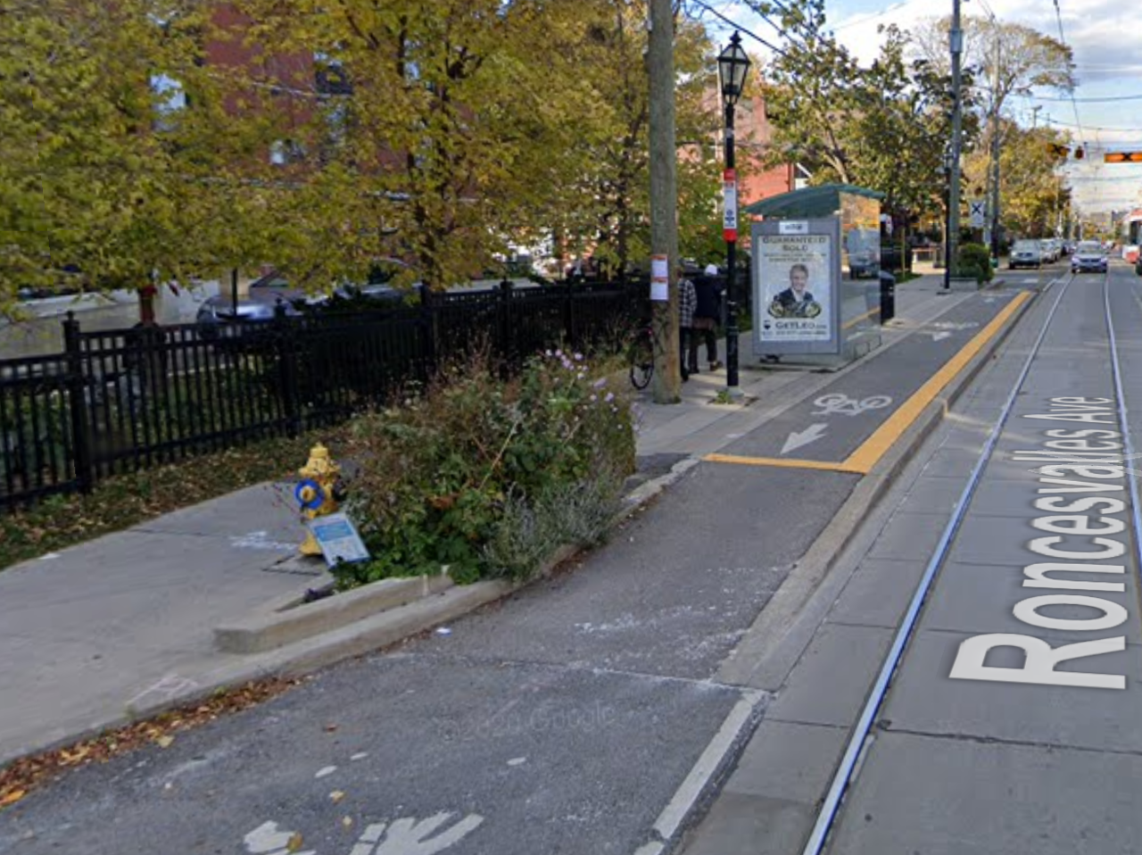

That's Roncesvalles Avenue. Because of the King-Queen-Roncesvalles-Queensway intersection reconstruction, they are using buses.

That's literally Roncesvalles Avenue.
Well, not exactly...but I guess its the same idea.
On Roncesvalles, there are extended curbs, but they are designed for bikes and not wide enough for automobiles. The design I was referring to would kick automobiles out of the two centre lanes to turn them into dedicated transit lanes for streetcars. Automobiles are relegated to the two most outer lanes with passengers continuing to alight at curbside (hence the extended curb). Off-peak hours, on street parking is allowed and automobiles can share the centre lanes with streetcars.

I’m not a fan. Streets like Queen are functionally 2-lane roads anyways, as the curb lane is almost always blocked, and the main bottleneck for motor traffic on these sorts of streets is intersections, not the number of lanes on straight sections. Trying to keep the extra lane open is pretty futile.
The priority between cars and pedestrians is also super unclear - all road markings as well as the pavement surface signal priority for cars, but the change in height signals priority for pedestrians. I could easily see this being deadly - pedestrians think they can wait on the raised area, cars think they have priority (and technically do, when there is no tram there). Even worse, outside rush hour there will be no cars on that raised platform-road thing, so people will probably start getting used to waiting there especially when it is crowded, and then during rush hour it suddenly becomes a car lane? This is especially ambiguous when transitioning between rush hour and non-rush hour periods.
I think Toronto has a decent approach on Roncy. The same sort of conflict exists on Roncesvalles, but it's a cycling-pedestrian conflict which is not a big deal, unlike car-pedestrian conflicts.
Also, side note, that "bike lane" is such a joke, it's like a foot wide and also blocked by the parking.... how is that even legal in Australia?

I too like aspects of the Roncy approach.
The pedestrian/cycling only bumpouts at stops prevent passing of streetcars at stops which is critical to passenger safety.
But I also think, on Roncy as elsewhere there really are too many stops, too close together.
I'm not suggesting pushing them 500m apart; but one stop I measured was only 238M; that's just not enough space between stops.
Barring crossing extremely major roads/destinations I think a hard floor of 350M between stops is needed.
Otherwise, replicating the idea of that model on legacy streetcar routes where an exclusive ROW is not viable is something I could get behind.
But we do need to pursue exclusive ROWs where they are low hanging fruit.

They actually removed streetcar stops on Roncesvalles. They also removed the Sunday stops entirely.

The Sunday stops were an anachronism in contemporary Toronto.
I don't know how many regular stops they cut when they re-did Roncy, but they missed a couple! LOL

Think they don't have transit priority traffic signals on Roncesvalles. So the streetcars might stop before the lights and again at the farside streetcar stop.
