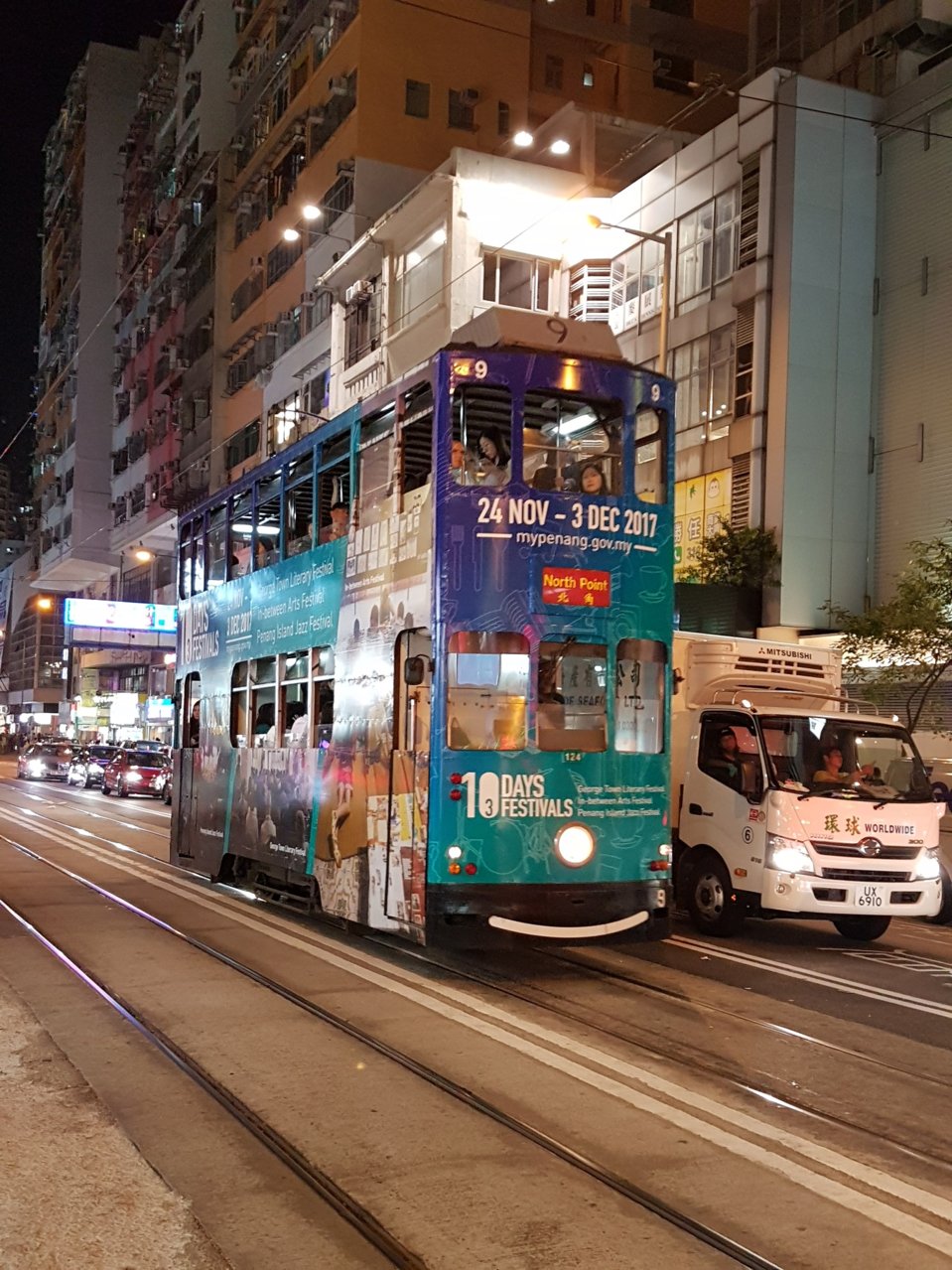

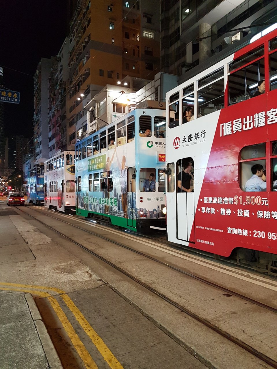

I love Hong Kong's mixed traffic double decker streetcars. Here on Johnston Road in Wan Chai.

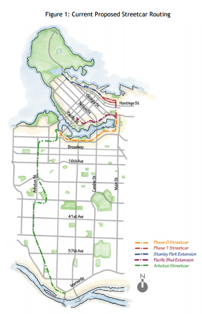

Vancouver just issued an RFP for a streetcar feasibility study:
Summary Details:
The RFP concerns the City's interest in procuring a consultant ("Consultant") to future proof the planning of streets and development within Vancouver so that a modern streetcar system can be constructed in the future. Details of the City's objectives and requirements to which the RFP relates are set out in Part B of the RFP. The City welcomes proposals that are responsive to this RFP ("Proposals") respecting innovative or novel approaches to the City's objectives and requirements.
Lots of details here:
http://bids.vancouver.ca/bidopp/RFP/documents/PS20171493-RFP.pdf

Arbutus as a transit corridor (again) lives! Interesting...
That's just what I was thinking. I thought that had died when they selected the Canada Line alignment. And it does meet the existing track along 6th Avenue quite well, and would interchange with the Canada Line at Olympic Village, the proposed Millenium Line extension at Arbutus, the Expo line at Main Street–Science World, and provide excellent transit to the entrance to Granville Island. And that's if they only build Arbutus and use the existing line. If they build the relatively short Phase 1, it goes into Gastown and the main Waterfront transit hub, meeting the Canada and Expo lines, along with the commuter rail and SeaBus.
It's almost a no-brainer. If it's successful, I wonder how feasible it is to extend along the rail track a bit further south from Granville/SW Marine across the existing rail bridge to the Bridgeport Canada line station. How well used is that bridge? How frequently do they need to open it?
Perhaps the short-lived Olympic Line will run again!
