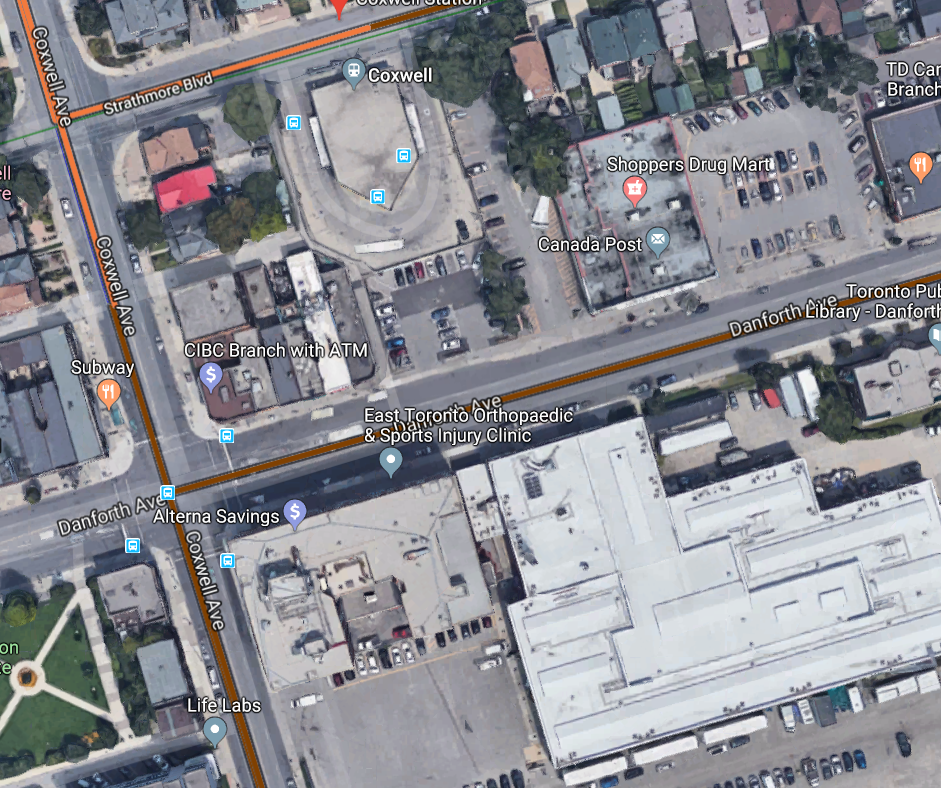

One thought I had on a Coxwell extension was to simply run it into a Danforth Garage paid area with a tunnel punched through to Coxwell mezzanine. This would avoid some of the congestion endemic to the Coxwell-Danforth intersection. But Danforth Garage is being turned into a cop shop so that's out.
There are two infrastructure issues to bear in mind - the GO bridge south of Hanson Street, the centre support of which pinches traffic to one lane each way, and the large sewer main running under Coxwell. There is also a steep grade up from Gerrard as far as Danforth.
If a portal could be done north of Gerrard, this would allow a streetcar tunnel to rise at a gentler grade and pass under Line 2, but that would be an expensive platform to construct, and there would be sensitivity to disruption of emergency vehicle access from Danforth up Coxwell to East General Hospital depending on the construction method. Parallel bus service would need to remain as there would be no business case to construct intermediate stations. However, were the track extended beyond Danforth then the major trip generator of East General Hospital (plus the East York Civic Centre and connections to the 62 Mortimer) would be an appealing destination especially if a loop and station/operator rest facility could be done under the East York Civic lawn.

A tunnel longer than a football field to get to the Coxwell TTC route?
How is this an upgrade from the existing bus stop that's virtually on top of the subway tunnel?
I admit putting an entrance from the mezzanine outside into the city property near the Bus Terminal Diner would be useful for pedestrians, and provide better walking access to Danforth.
However moving the surface platform to south of the apartment building south of Danforth won't help transit! I don't know why anyone is suggesting anything like this.
Only two TTC routes serve Coxwell Station. 22 COXWELL and 70 O'CONNER.
From link.
So by having the streetcar using both Danforth and Strathmore, and the parking lot, the streetcars could use either the current 22 or 70 side of the current bus terminal.

See also this link for more information on the Coxwell Station.
From link.
